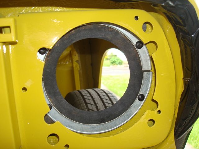

Here's an example of the felt seal and two half rings in position on MikeyB's car.

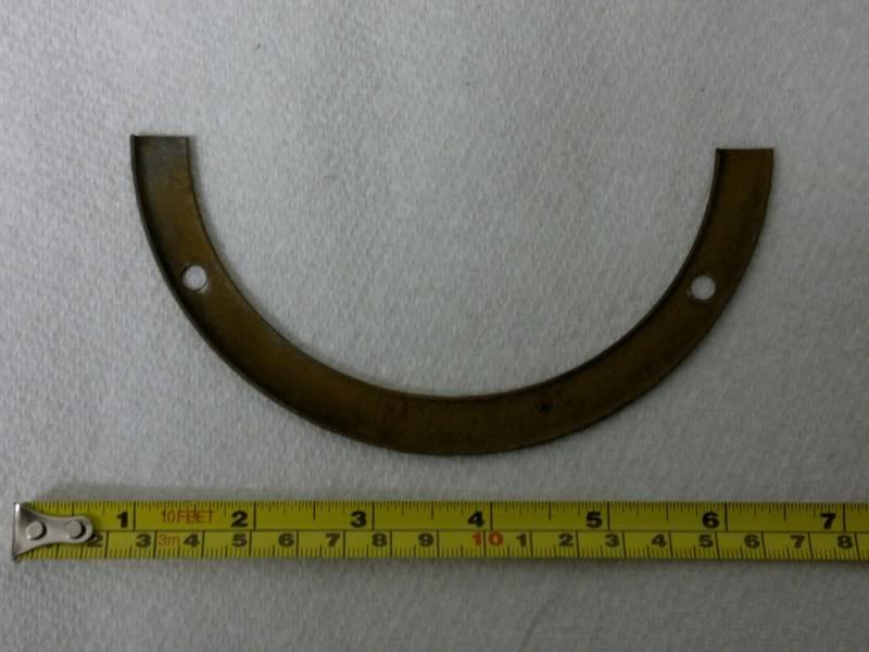

Here's what my only decent half ring looks like. Sadly instead of plastic rivets someone screwed them into spire nuts where it all rusted together. I was lucky to salvage this one.
Clearly with no suitable NOS replacements and even good used available it might be tricky. I'm therefore going to look at having some made up.

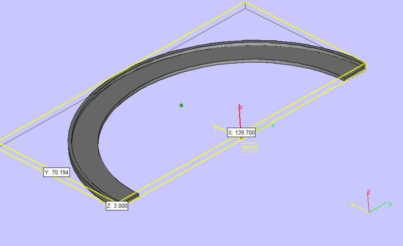

Option 1) 3D printing - This would involve reverse engineering the part using CAD software and then printing them out in resin. This is good for small runs. Being plastic too they won't rust! Potential supplier has got very keen and already mocked me up a CAD drawing from a rough picture I sent him.

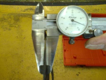

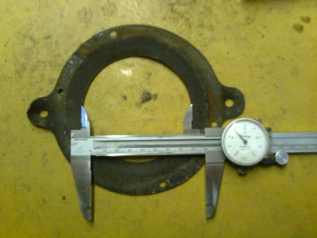

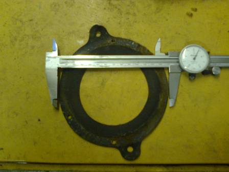

Just measured the ones off a 1979 car
OD is 140mm approx
ID is 89mm approx
Thickness 1.5mm
Pictures later.

I have made a (first attempt) template but obviously there was no need since Tony has come up with the dimensions :D .
