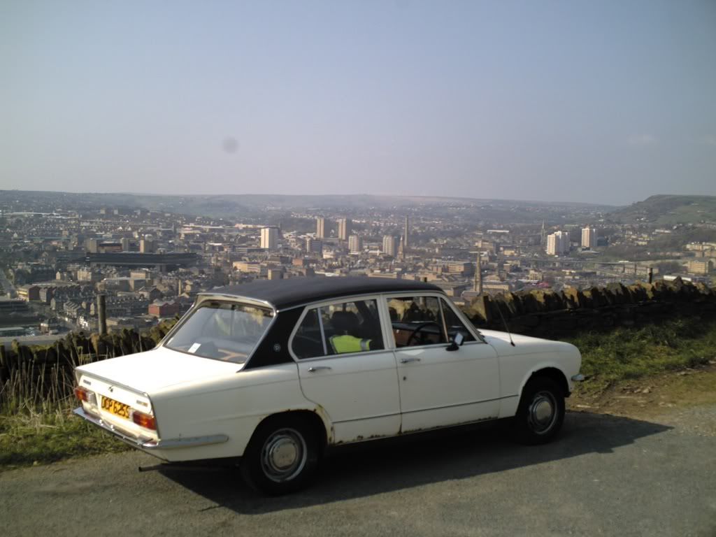

Richard if you upload your pics on somewhere such as Photobucket and put the IMG links in your post and the pics will appear in your forum posts like so:
That is Halifax in West Yorkshire looking towards the town centre in a northwesterly direction. By coincedence Snowdrop has a Halifax number plate.
Edit: I've found the exact spot on Google Earth.
