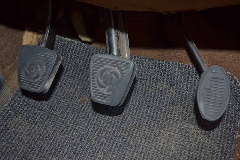

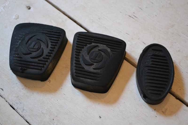

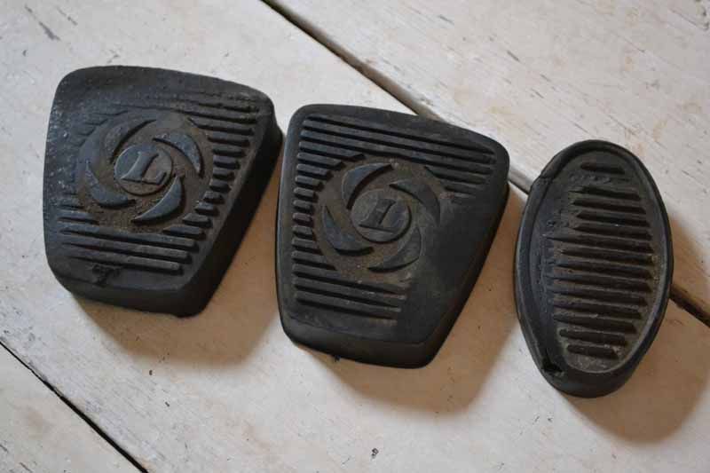

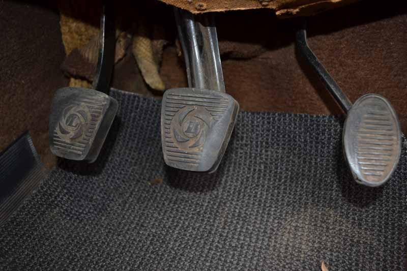

Right then boys & girls, here is the next exciting installment of 'operation MEL'...!!! It was one of those boring Sundays where my good lady wife had left me on my own for the day (very dangerous!) so I wondered " hmmmm, what can I do today" and I just thought I'd clean my disgusting pedal rubbers...!
They get a lot or, ermmm, 'stuff' in them so I thought it best to take them off and give them a scrub to bring a bit of cleanliness down to the foot area...
Please excuse my horrible carpets...!!! I think that getting those rubbers off was far easier than getting them back on I can tell you... I wish I'd actually cleaned the pedals and their 'arms' as well now... :roll: That was just one of those satisfyingly easy jobs that, although the results are not amazing, made me feel like I did something with my day :lol:

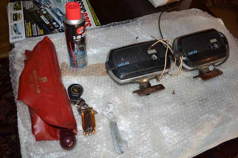

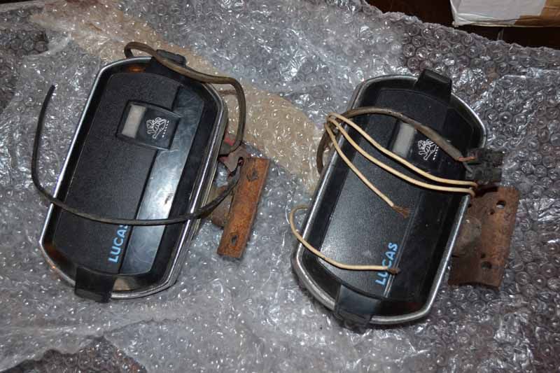

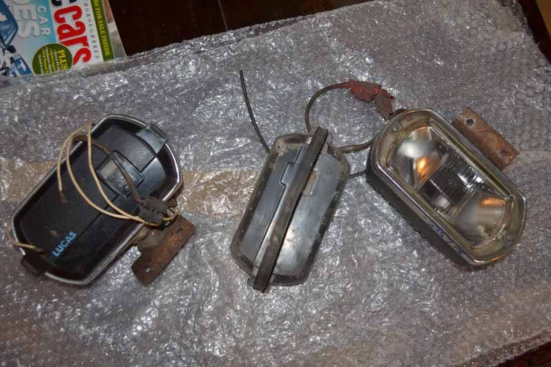

Next up, restoring my Lucas 'Square 8' spotlamps...

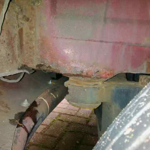

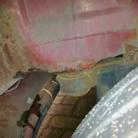

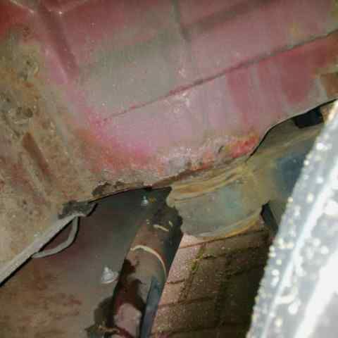

Don't you just hate finding rust...?!
I found this patch a couple of months ago and I have just not had the time to remedy (or get someone to remedy!) this area!!! As well as this I have some crusty old rust towards the rear of my sills that is creeping up into the arches so things need to be tackled.
I have been given the contact of someone who is ruddy good at fettling these old brutes (many thanks Mr.Tilson!) so I will have to make arrangements in the new year to get rust cut out and metal glued in!!!
Until then though I am thinking of taking it off the road until Spring...?! I don't want to let things get any worse and I am not in a great position (money or time wise) to do anything now so I think I have to preserve my beloved Canley critter as things are getting a bit gritty and salty out there.
Do you good folks think that that may be the best thing to do...?!

Re: 1976 Triumph Toledo... 'MEL'...!
#10 Post by DoloWIGHTY »
I know a lot of people will disagree with me but I keep my car running all year, laying them up (in my opinion) is a bad thing to do as rubbers become less supple, box sections get filled with moisture, engines get coked up with running them on choke, batteries get discharged - the list goes on. A good soaking of some form waxoyl in all the usual places along with washing off salt shouldn't be too much of an issue.
#12 Post by Jon Tilson »
Give the engine a run up to fully warm every week or so and exercise the clutch hydraulics and rear brakes at the same time if you can...
Most of the rust in those pics looks like it would respond to a good wire brush and bilt hamber or jenoliting....
Don't leave it like that or it will start to become holes....
#13 Post by Jod Clark »
Jon Tilson wrote: Most of the rust in those pics looks like it would respond to a good wire brush and bilt hamber or jenoliting....
Once again, chassis leg rust on the same side as the battery lives..
grifterkid
#14 Post by grifterkid »
Uh-oh... Jack through jacking point shock-horror!!!!!!!!!!!!!!!!!
I should not have used a silly little hydraulic jack with a small lifting post part (about 1 inch in diameter) but that's that now.
I can feel some metal work coming on very soon now! Oh well, I suppose I will just have to bite the bullet and list all the crusty spots and get them sorted out soon.
I can see a few of these ££££££££££££££££ leaving my pocket fairly rapidly... :roll:
Dolomite1296
#15 Post by Dolomite1296 »
Aaargh, not the dreaded bottle jacks?! Still, it's done now and may have done you a favour in exposing the amount of work required. I'm sure you'll soon have it all sorted as it doesn't look that extensive, best to nip it in the bud whilst you can.
On the subject of jacking points, even if they are resolutely solid it is best not to use them. The Dolomite range is ideally jacked on the subframe at the front and the axle at the rear.
I look forward to seeing how your restoration progresses.
