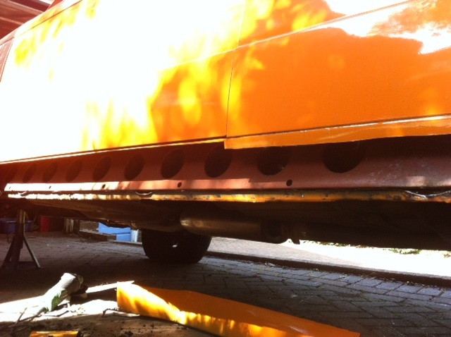

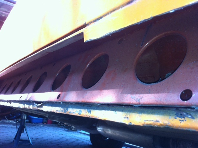

#18 Post by ToledoZombie »
Got this off and will strip prime and offer for sale , thought it does have small bits of corrosion at the ends

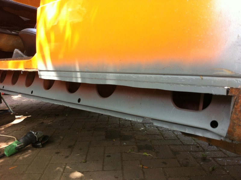

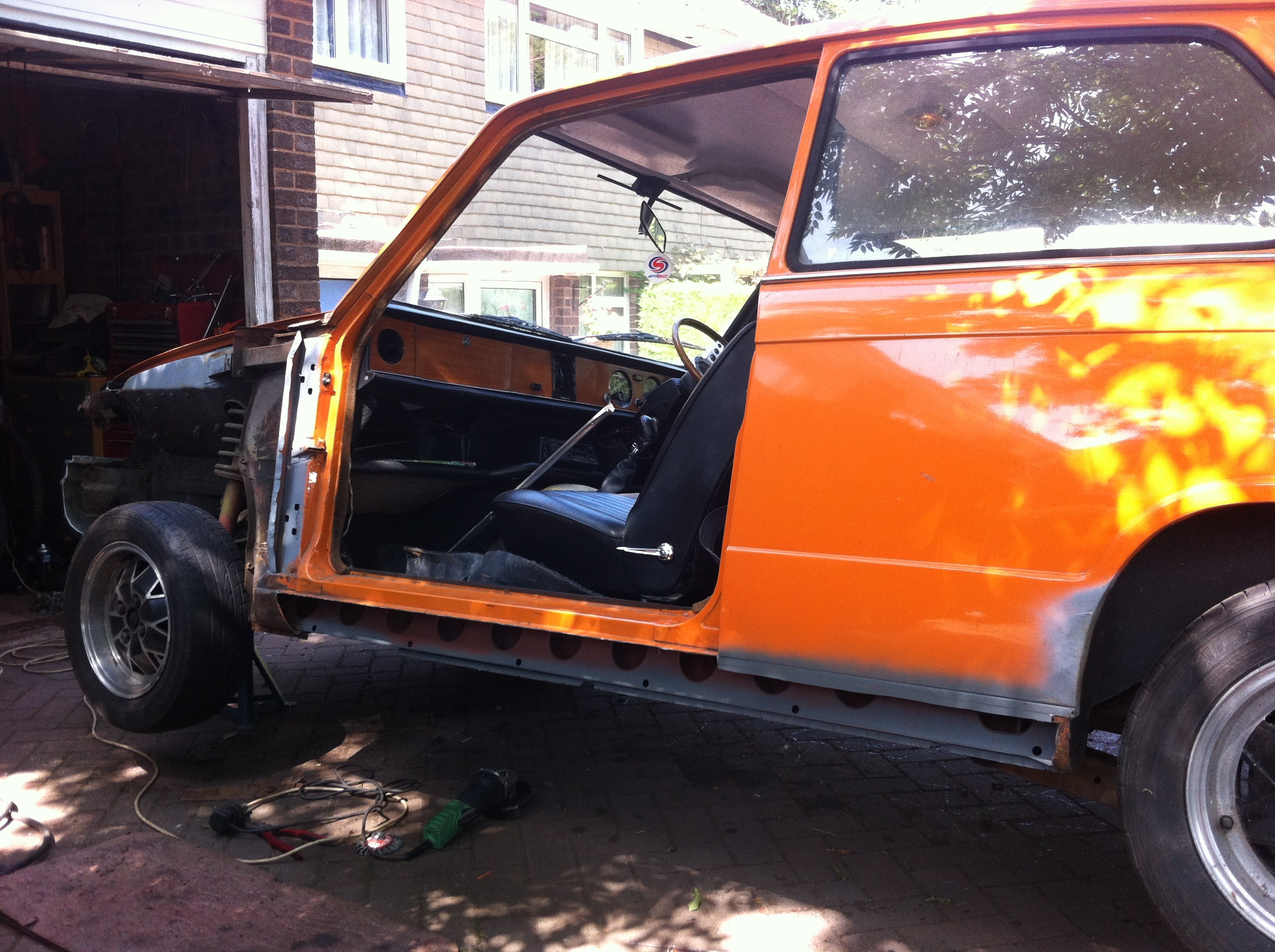

#26 Post by ToledoZombie »
I have made a slow start today on Chuckie, many thanks has to goto Alun for his great service supplying the panels.
I've started with the nearside cill. Looks like I will be renewing parts of the inner cill while I'm at it
1971 2 door Toledo aka Chuckie (porsche orange)
Re: Wing removal and front end overhaul
#27 Post by DoloWIGHTY »
As you say, that reinforcer only looks a few weeks old - good result :thumbsup:.

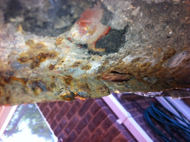

#28 Post by ToledoZombie »
I was very surprised after 42 years hidden away inside the cill
