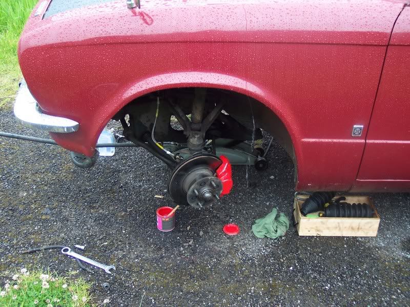

Fitted front braded flexis today, rain stopped me doing the rear one. I've heard people say they firm the pedal up and was interested to see what they were like. And they do firm the pedal up! Quite worrying how much flexis do swel up under pressure.
