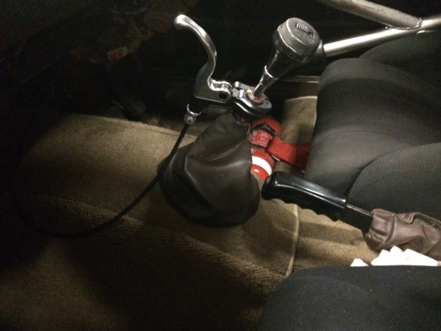

The alternative for those of us who could never properly master heel & toe is what I've been using in the racecar for about five years:
race gearlever.JPG (102.31 KiB) Viewed 1268 times
Hand throttle so easy to blip the throttle as you change gear. I've had no issues raised at race scrutineering or when going for our version of MoT for use on the road. Both this and standard accelerator pedal operate independently without issue and with just small modification where the cables attach.

gmsclassics wrote:The alternative for those of us who could never properly master heel & toe is what I've been using in the racecar for about five years:
Looking at that photo before reading the text, my first thought was a hand operated clutch... Would that actually work? It'd take an awful lot of getting used to, but then you could left-foot-brake as if you were driving an automatic, and I'd imagine the act of squeezing the handle as you pulled the gear lever would be fairly natural...

inspired use of a pushbike brake lever too! :eureka:
