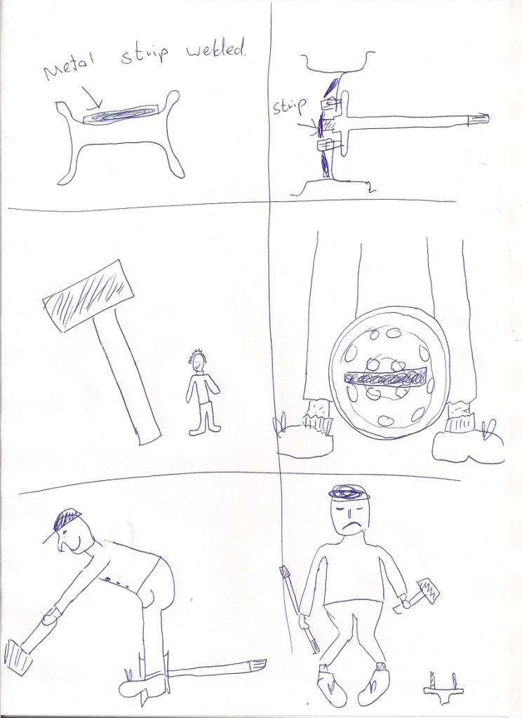

Using a press does deform the bearings and they dont come off. Most of the time a big hammer does the job.
I made a how to last year using a steel wheel as a hub puller.

Jeroen, you artist !

Steve, that's the easy bit.
Jeroen, does this work on Dolomite rear hubs? I know that this method was used on the Herald halfshafts but the Dolly is a different beast.
