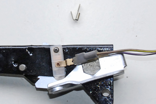

Making the connections would be easy for it requires no more than two of those piggy back spade connectors, one on the handbrake switch and one on the overdrive solenoid and a couple of lengths of wire – as seen here with one of the piggy back connectors sitting just above the handbrake mechanism.

However it was not quite as easy as that for the handbrake warning light is activated when the handbrake lever switch provides the earth to the light – in much the same way as the courtesy light switches in the door pillars activate the interior light. The overdrive solenoid is activated when the gearlever switch provides 12 volts to activate it.
The solution? I used a relay which is activated when the overdrive switch activates the solenoid and then through the relay contacts it provides another earth path for the Handbrake On light.
I had some spare wires left over from one of the several Dolomites which arrived here in parts over the years. They yielded a pair of wires with the single connector which could sit alongside the wiring loom which comes up from the gearbox and which can be unplugged if and when the gearbox is removed from the car. Another piece of wire runs from the handbrake mechanism alongside the tunnel cover but on the left hand side and runs up to the relay which I have mounted in behind the glove box using one of the heater mounting bolts to hold a simple plate to which the relay has been screwed.
20140811-4849Pw Sprint overdrive indicator relay.jpg (108.16 KiB) Viewed 2091 times
The result? Turn the ignition on and if the handbrake is activated then the indicator light will be on. It can only be the handbrake unless you happen to start the car engine in third or fourth gear with the overdrive engaged, which in my case is most unlikely. I now have a clear indication of when the overdrive is engaged.
