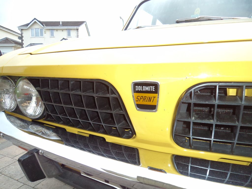

This is the correct early Sprint nose badge.
The later ones had TRIUMPH in black letters on a silver background and were fitted to the entire Dolomite range.

I think Graham is telling us he has two slightly different versions of that badge Dave, and one of them is an exceptionally rare early original with slight relief to the letters similar to the early rear badges. I have seen very few cars wearing such a badge, including fairly early original/unrestored versions which have the flat version.

Ah, I didn't make it clear. It's the one on the upper front panel that reads TRIUMPH I mean, not the Sprint (or 135) nose badge.
