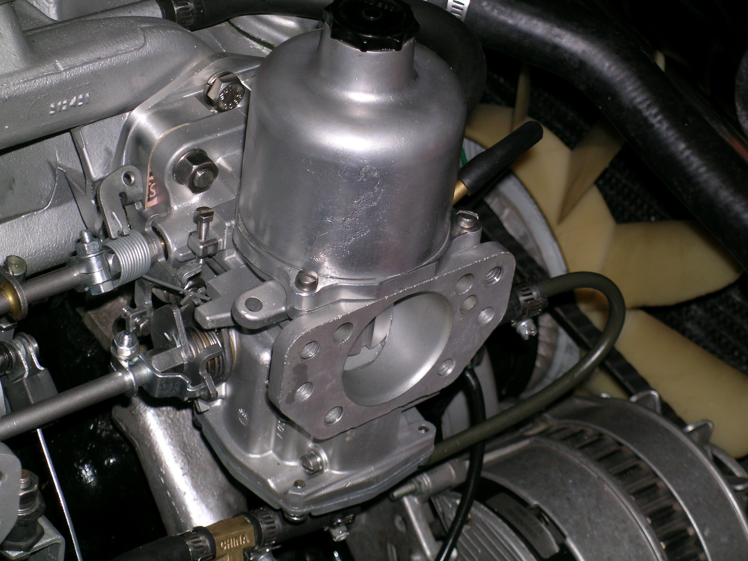

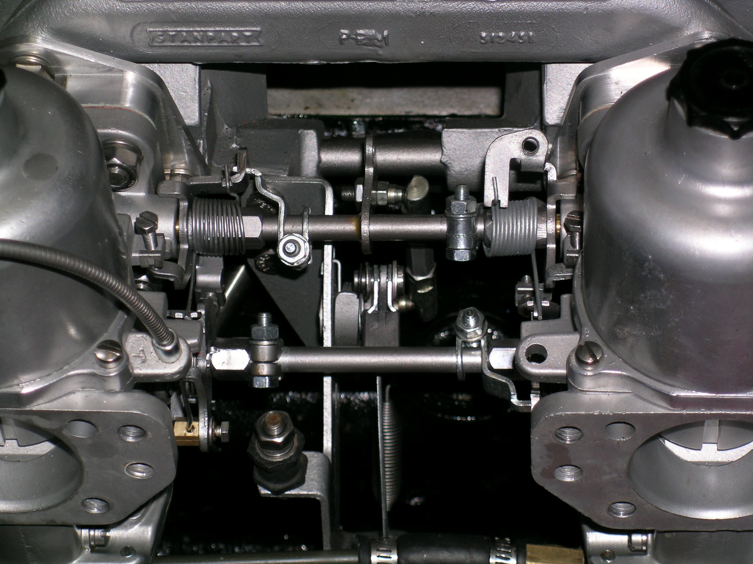

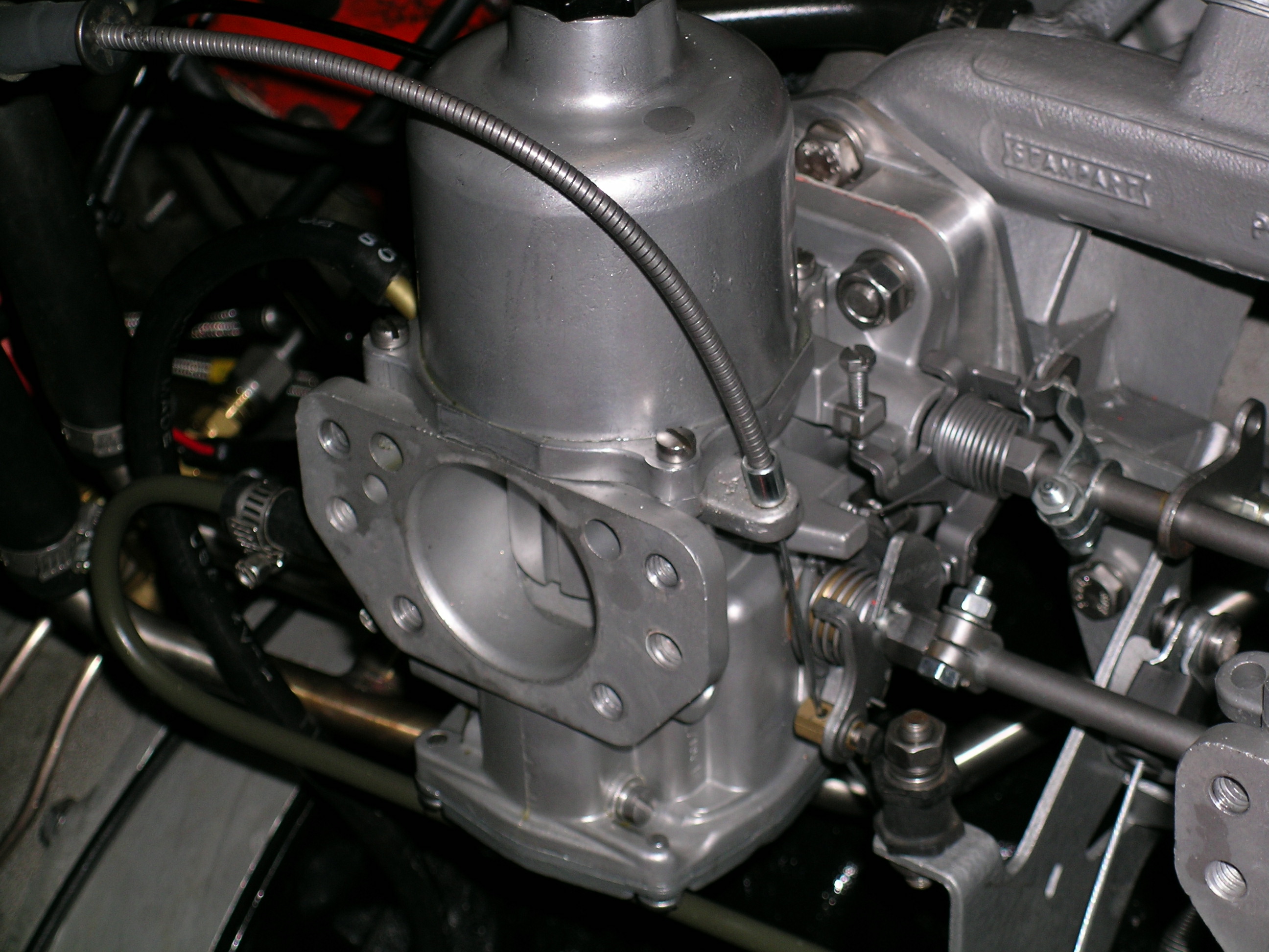

A few pics of he HIF6 installation on my Sprint.
As they flow more air and I'm running a Newman
Phase 1 cam, I have BAW needles, slightly richer at
the top end than the BBTs.
