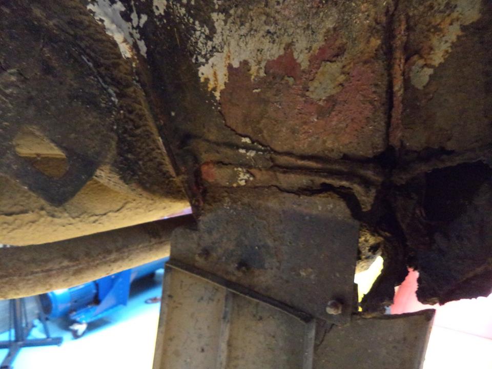

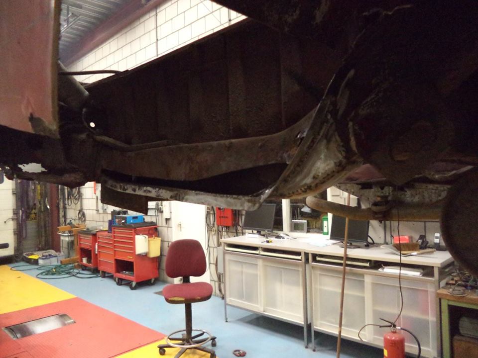

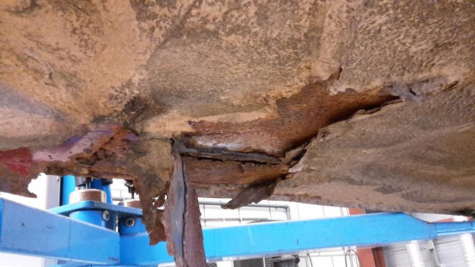

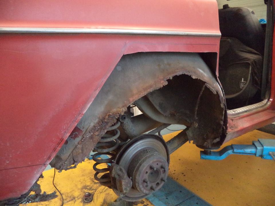

Next week some welding to the volvo. I did decide to keep this one because of it's load volume. The nicest is that all panels are available.
After a call to mister Alun Nichelson in Denmark all arrived today.
Re: Start with the other project
#2 Post by soe8m »

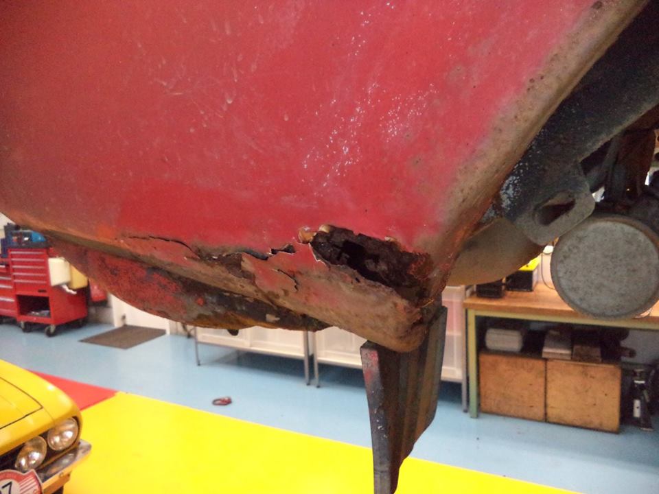

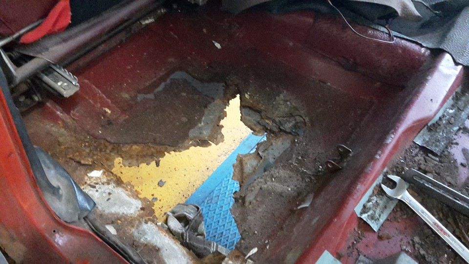

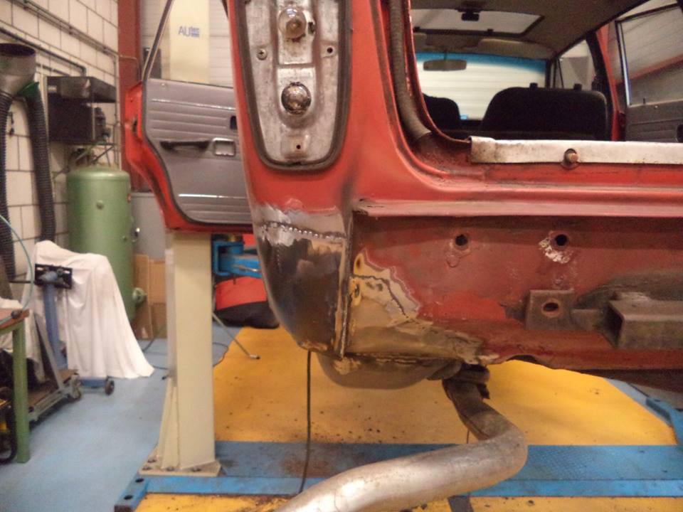

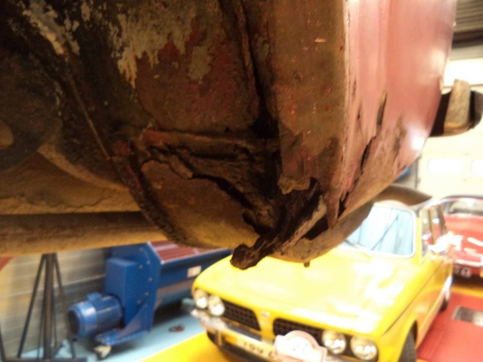

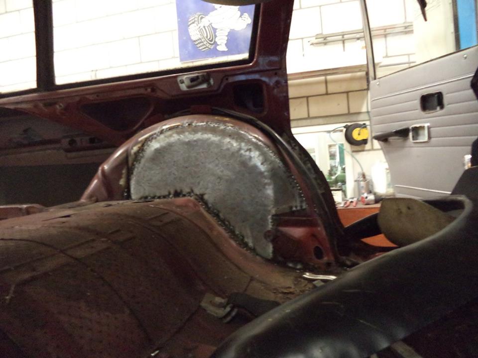

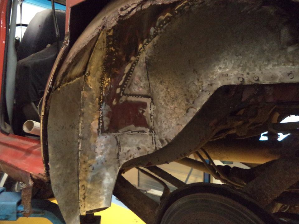

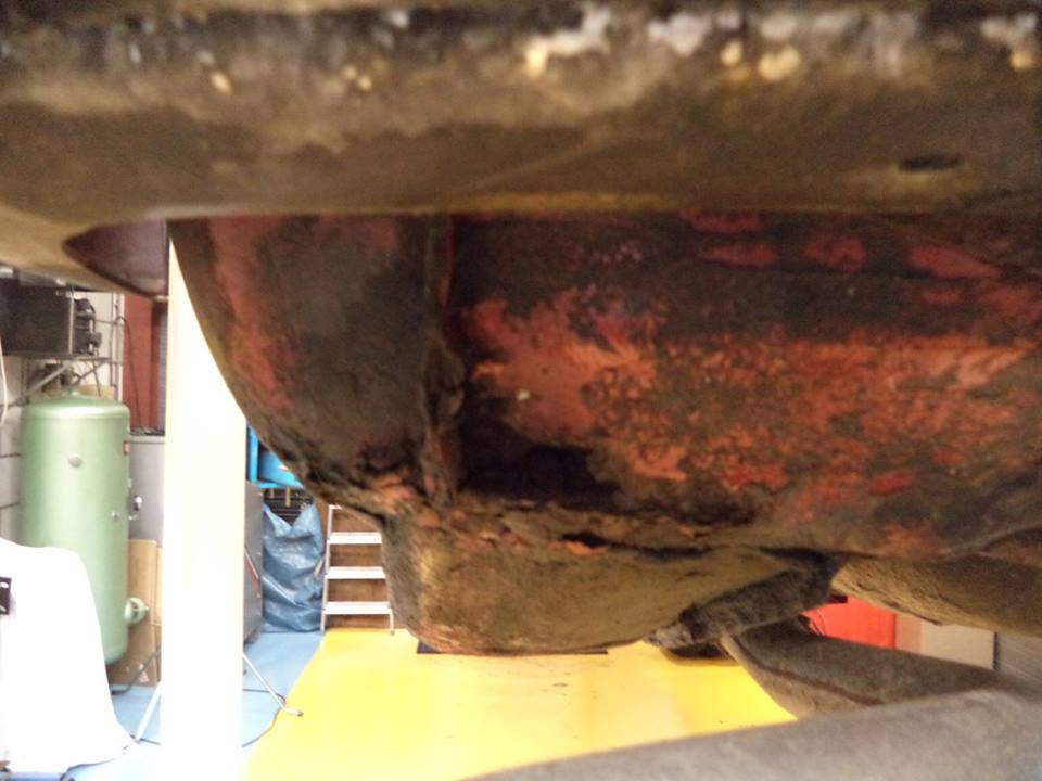

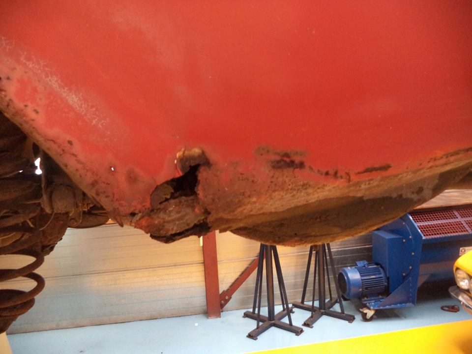

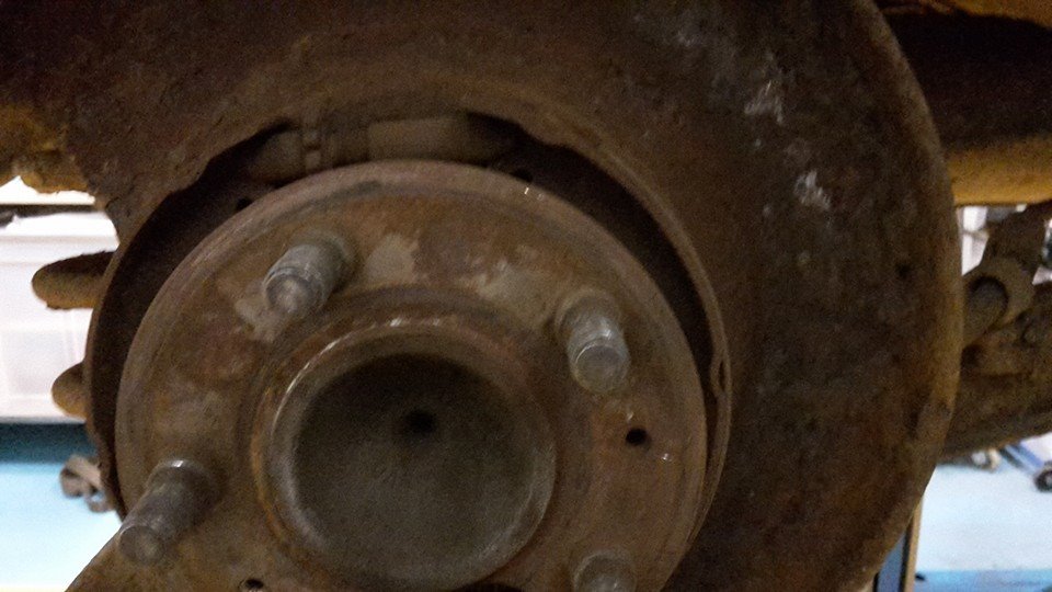

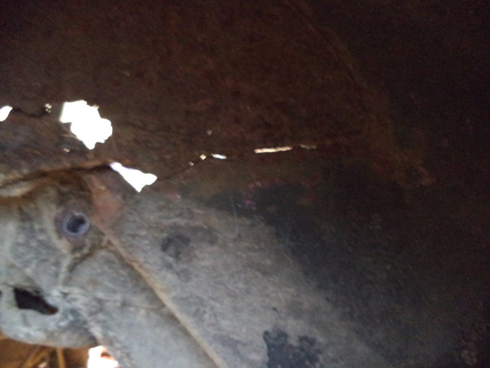

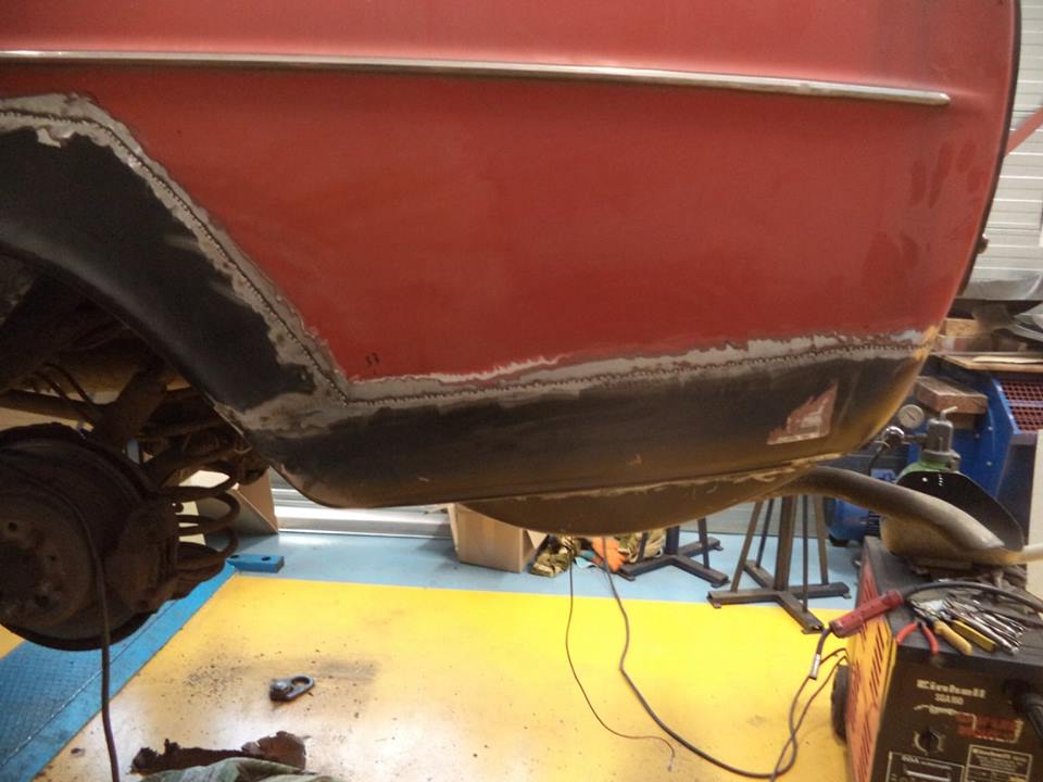

Here are some welding pics. It's just functional and not a concours resto. I cannot do without it's space and the yearly costs are 42 euro for insurance a year and tax free.
The pics are not sorted.

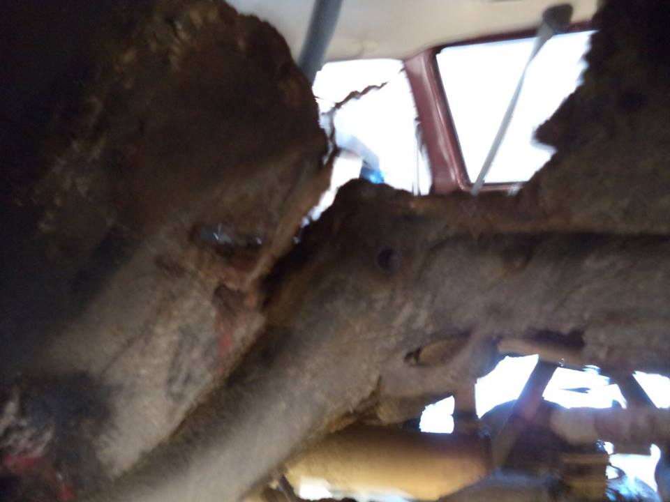

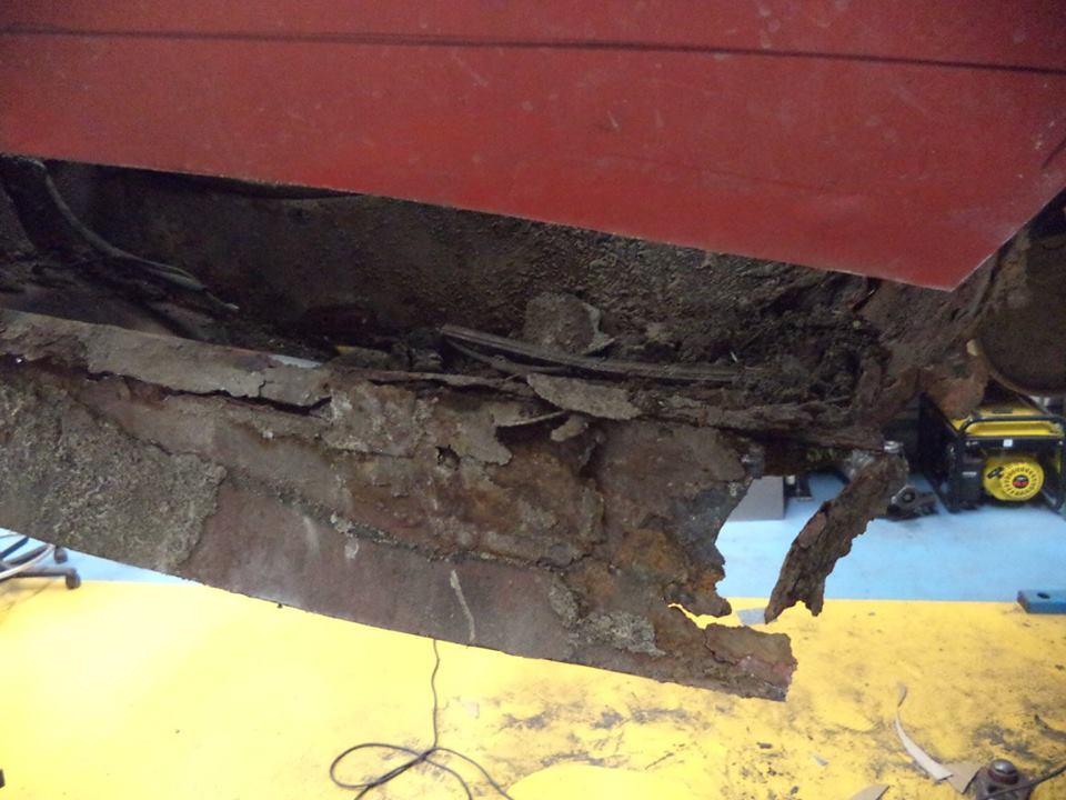

What a horrible mess, you're not scared putting that thing on a 2-poster!
The garage is immaculate. :)

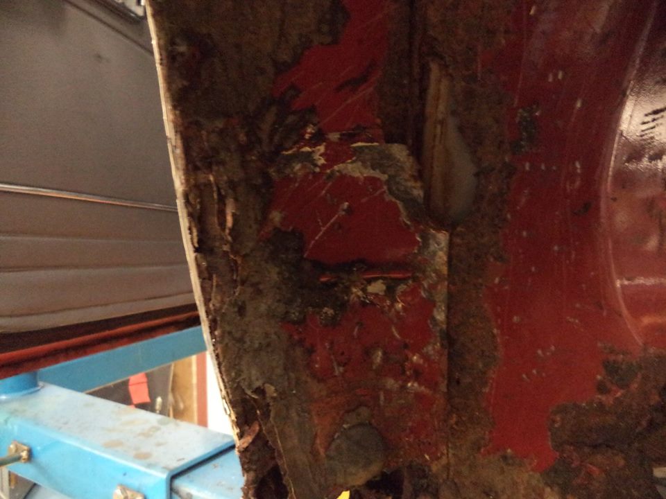

It is quite a mess but the panels are a good fit. All profiles and bulges do match the original. The thinnest original metal is 1,5mm so the welding is not that a challenge.

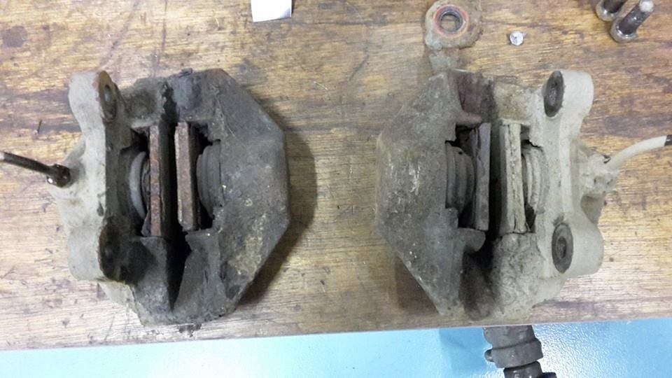

The workshop is at Hans at bccp. The car was more rotten than at first sight. There's also already 1,5m2 sheet metal welded in. :? I think it's 1,5 day welding left and then some technical issue's. The car had one working caliper left. The rest was braking continuesly. I never did anything on that car, only local driving with building supplies but now is the time. Two years ago i did MOT it myself :D but now i'm not working at a garage anymore i have to let it MOT and that brings some work with it.
