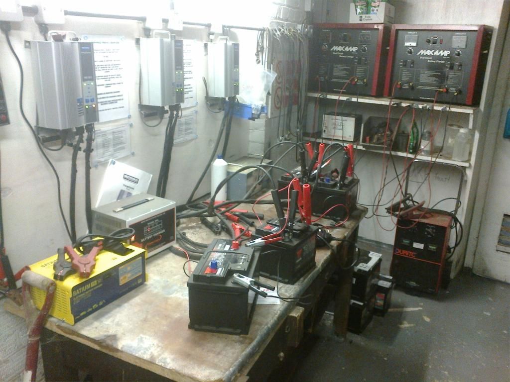

Just to further push the point for Jonners, as i know he will still be convinced he is right:
(i love him really)
This is my test bay at work:
On the wall, three Midtronics Charge X-Press Pro 50-2 double charger units at around £400 each
On the bench is a GYS Batium 15-12 at £139 + VAT retail
Next to it is an MPL Traction Charger at £399 + VAT
Theres another, older version on the shelf below the red chargers, this was similar money but is now 10+ years old.
The large red chargers are rather older, they are constant voltage bank chargers and are capable of charging up to 6 batteries in series per bank, so thats up to 24 batteries in one go. They were £1000 plus many years ago and are updated and repaired on site as required.
You will also some of the test gear i have - the old Wilkson WL18 Carbon Pile tester is a favourite, also visible is the latest Midtronics MDX-617 Conductance Tester - i have half a dozen of these, in various versions... The latest one i helped develop and de-bug the software thats now installed as standard.
Now if theres anything you think your £19.99 Desulphater can do that i cant do with the kit I have here, i would be very happy to test it....
