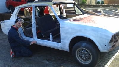

The restoration on LRM (VA930) is slow but steady.
Have completely removed the sun roof which I think is beyond repair.
Would not like to go along the road of replacing the roof so will need another sun roof to fill the 99cm by 83cm gap.
Can anyone suggest a half decent sun roof without me having to take out a second mortgage!!!
Cheers!

Well, there is another way what i did at my wife's 2500. It had a big rotten sunroof also. I did cut out a roofskin from another 2500 and glued it over the existing with body glue. Then added a vinyl roof and it's invisible.

What kind of sunroof was fitted before?! Maybe you can fit a Webasto or similar to fill the gap and keep it looking original for the period?
Failing that I am sure a new (or good S/H) roof skin can be cut to fit the gap or a whole nes section can be fitted.
Whatever you chose to do I am sure it'll end up looking pretty much perfect!
Please do keep us posted... :wink:

This sounds a good idea but is it that easy? There are stiffeners in the sunroof, did you use any stiffeners when you glued the roofskin?

It needs two man. You cut out the remains of the old sunroof and lower the other roofskin on top of the car. I did some tackwelds at the edges and a bit of filler to smoothen. It was done in one evening. You only have to buy an headlining and the frames because that will be cut in yours because of the sunroof.
