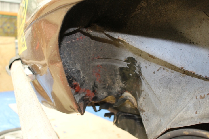

Where the wheel exited - rear of wheel arch and under car

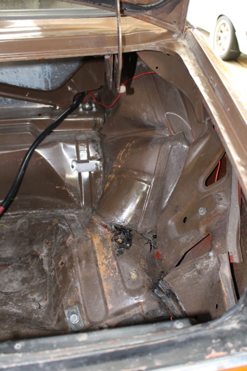

Damage from inside boot. All panels affected, worst is wheel arch. Battery straps held that in place but it moved that much that one of the terminals was ripped out, spilling acid everywhere

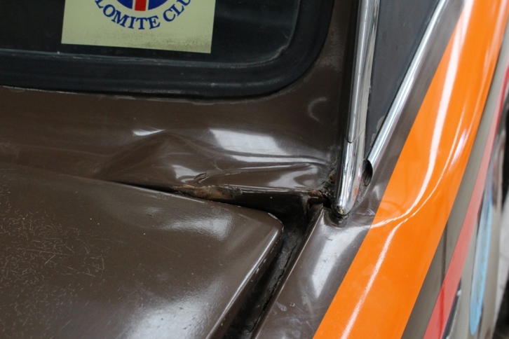

Creased panels at base of C pillar.  Boot won't close.

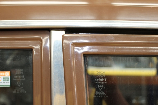

Distortion to drivers door frame
ditto
ditto

Hi Geoff, You were lucky not to roll the car ,however try taking it to local body repairers .It will need putting on a jig and pulling to the rear and down ,then lots of panel beating.
If you have a good shell it might be cheaper to reshell it as labour costs could get large .
It is not a diy job with that amount of distortion ,without good measurements it will only be trouble.
Hope this is of use and good luck

Ive seen far worse than that repaired. Wants the quarter panel and inner arch cutting away, then pull the rear down on a jig - this should pull the driver's door gap back into line. Then panel beat the floors and edges straight again and weld on the new inner arch and quarter from your donar car. Its certainly not a DIY job, it needs doing by someone who really knows what they are doing, but i would think its far quicker to repair that then reshell - especially if its a seam welded and caged shell.
Dont give up on it, leave it on the trailer and go visit a a few body repairers, hopefully one of them will have the enthusiasm and skills to get involved with the repair. Ideally, you want someone to do the jig work only, leaving you to do the panel beating and fitting of the new panels. As its a race car, it need not be as perfect in terms of panel gaps as a show car, as long as all the suspension mounts are in the right place it will handle as it did before - thats down to the skill of your jig man. I would not have any problem driving that again after its been repaired - done correctly, it will be as strong as the original shell, or stronger, if you seam weld bits that were spot welded originally!
