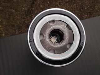

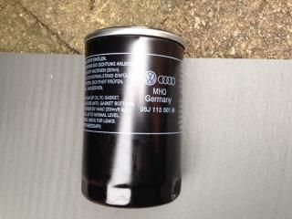

I have a couple of spare VW oil filters with a male centre but found this unscrews and wondered if it would fit the sprint. I assume all modern filters have non return valves so if it spins on and the seal hits the right area any reason why I could not use it. I don't have a filter to check against so can anyone tell me the diameter of seal required so that I can check ?

I had these as spares and thought it would be good to make use. They are for a Passat. If oil pressure was the same would this be a good gauge as to suitability ? I certainly don't really want to go back to the old style now I have spin on. Any idea of the seal diameter anyway.

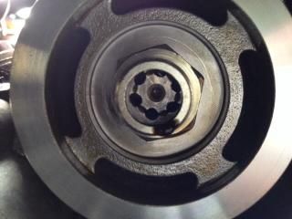

A spin on conversion does restrict the oilflow. On a "normal" spin on engine the threaded tube goes directly into the oilway's. On the spin on conversion there's the threaded hole in the centre where the long bolt used to be. The tiny holes drilled on the side of the centre adapter where all the oil has to pass have a very small square area altogether compared to a std filter setup. Less oil is pumped into the engine. Oil pressure and oilflow are totally different things.

If you read the Jeroen post again he says the restriction is in the adapter not the filter.
Re: Oil filter
I think there are good & bad spin on adapter kits, the one fitted to my car is one of the better ones, I don't know the make, but you need to check the 6 holes in the threaded part are drilled deep & also the adapter ring doesn't block the oil feed in the block.

Well the holes look ok in the adaptor, the sealing face was the same diameter and the longer VW filter just cleared the steering so I went for it.

Those tiny 6 holes i would call a restrictor.
