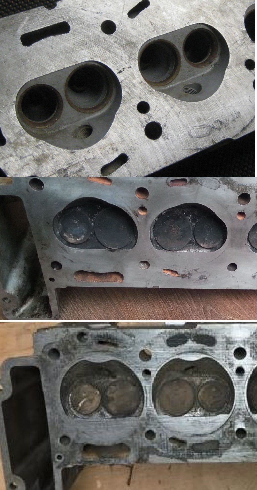

#13 Post by soe8m »
Googled some heads.
The upper is an 1850 one and the lower two tr7's.
The middle has a bigger cut out around the valves so a bigger combustion chamber. The lower is a low compression and this type i have two which was with the fuel injection sets.
