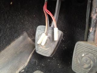

I don't think the following is related to above but I found these dangling about under the dash. Similar to the heater fan connections. I have yet to find where they would plug in to. Any ideas what they are ?
Colour is not clear but they are black and red.

They could be unused wires for the fog light switch and/or the panel light for the automatic transmission selector?

1. The two wires you have found are listed in the workshop manual as being fitted to all Sprints from VA15,001. They are probably White / pink in colour and feed items 6 and 84 which is an alternative heater motor supply and the radio supply. Though your radio may not be actually connected here. They should have +12V on them when the IGN switch is in the AUX position, so these items can be powered up without the engine being on.
