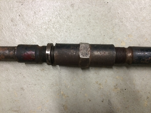

Apologies for being tardy in posting these photos. I gave the engineer an old arm which he cut, threaded (one reversed) and made the connecting piece and locknut. Trick is to ensure that the range in and out is known so it can be made long / short enough but still has enough threaded into the joining piece so it remains rigid and strong. I did have a pair made but now only use one, with a standard arm on the other side. Has been on the race car for many years now with no issues.

That's fantastic, thanks Geoff.
The more I look and measure the more I think an adjustable rod will sort this out.
Just one more question. ....what thread did you use on the adjuster? I'm happy to do the calculations on thread loads but just thought why bother if I could copy something that's already done!

Thread measurements are 16 pitch (per inch), 3/4" OD and just shy of 1 1/2" long.
