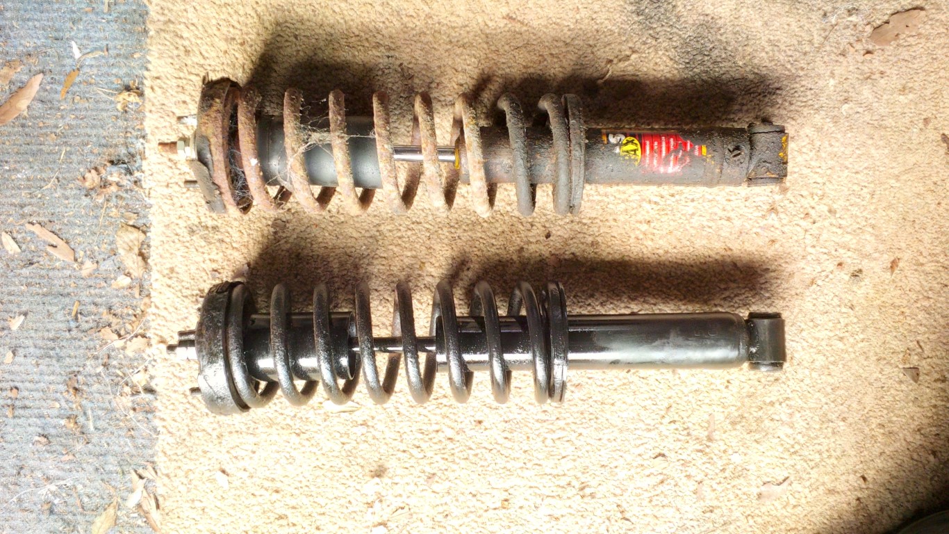

Replace the rear shocks

So, I have made a start and yesterday I replaced the rear shoocks for a pair that were in the boot, rebuilt the calipers with new pistons and seals and swapped the one halogen headlight it had for a sealed beam unit. A good days work I reckon and it ticks three items off the list.

- Old and new rear shocks
- Shocks old and new.jpg (391.51 KiB) Viewed 2523 times
