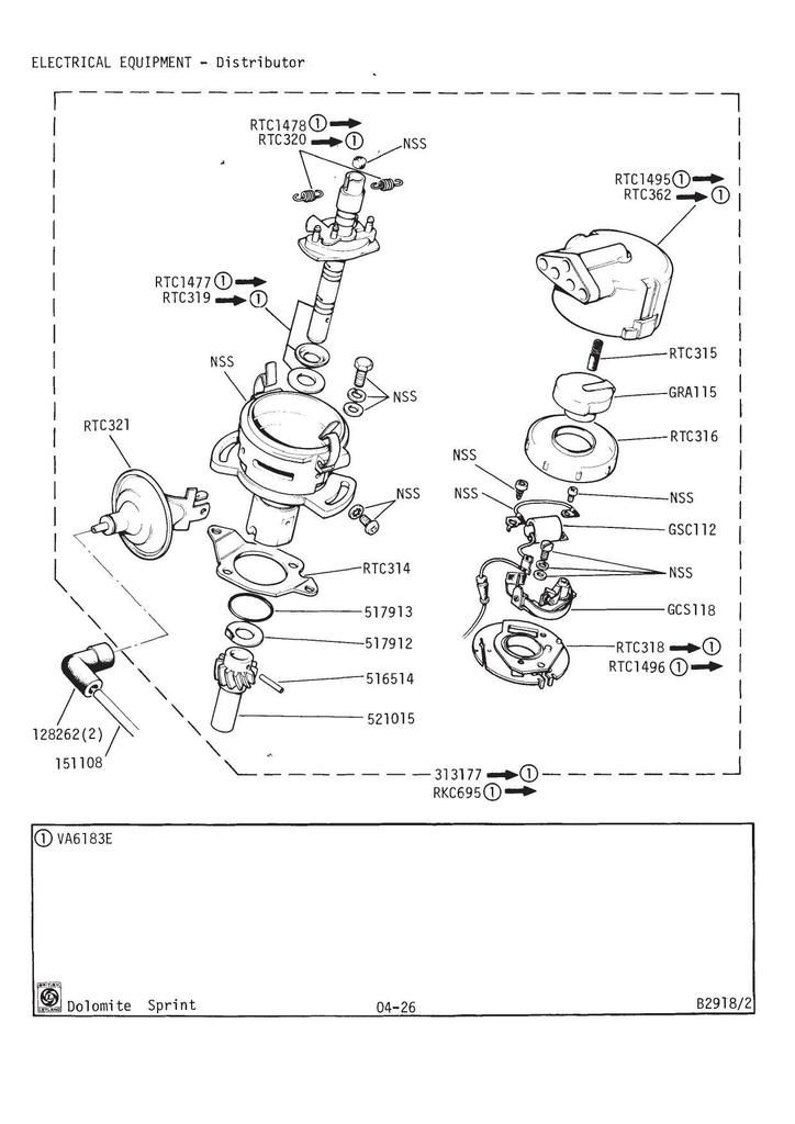

Looking at page 1N 08R of the Sprint parts book there is an exploded view of the various bits. There seems to be a lower thrust washer above the cog but also 2 extra ones at the top end of the shaft both labelled "NSS " -Not Supplied separately. And no set-up procedure in the manual either. I reckon these top washers may set the axial end-float. This may be why some owners have trouble with some electronic ignitions. The magnet moves too far up and down relative to the sensor.

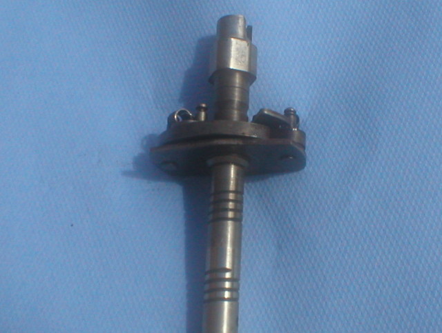

While it was raining I thought I'd dismantle this old distributor and have a look-see.
I got this far .....
Sprint dizzy shaft.JPG (69.26 KiB) Viewed 2966 times

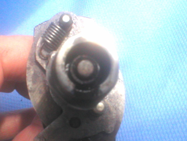

...and right now I can't see how to separate the 2 halves of the shaft. I thing it is something to do with this collar you can see in the end of the shaft where the rotor arm goes. I was expecting a circlip or similar; it obviously comes off from the top.
Any ideas please ?
Sprint dizzy shaft end.JPG (72.06 KiB) Viewed 2966 times
Posts: 8529
Re: Distributor shaft movement.
#7 Post by Mad Mart »
I've just done it on an old dizzy Tony, although the springs were missing. Apart from a small nylon bush in the top, it just slid off.

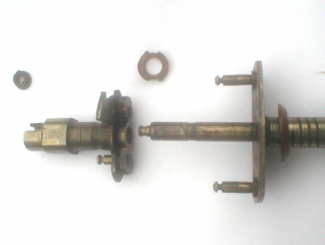

Thanks for that Mart . I got back onto this mini-project today and I found the following.
Yes, that top bit ( shown in Dave's parts list ) is indeed a nylon cap. Mine was very difficult to remove and I reckon I have ruined it in getting it off. I can see what it does. When the distributor is assembled there is a nylon washer with location tags for the "4-sided-cam bit" ( whatever it is called) and the up and down endfloat between the 2 co-axial top bits is controlled by how hard this top nylon cap is pushed down on the top of the shaft. So if there is a lot of movement up and down the lower nylon bush has worn or this top nylon cap has.
A solution: This nylon cap can be replaced by a couple of washers to set the end float and a circlip to keep it all together.
I found some brass washers of almost exactly the right size:
O.D. = 10.00 mm I.D. 4.78 mm ( or 5mm ).
Circlip I.D. = 0.153 mm or 3.92 mm. ( Probably 4mm will be O.K. ) O.D. < 10mm )
I'll see if I can get some next week.
Then I will have a good spare distributor.
sprint dizzy upper.JPG (38.46 KiB) Viewed 2804 times
Posts: 2336
#13 Post by MIG Wielder »
Most successful ! I got the necessary circlips and washers at yesterdays Woodcote Rally. I needed 3 washers plus the circlip and this reduced the top-half end float to about 25 thou. Yes it was a bit of a fiddle fitting the circlip but I got there. This is why Lucas probably fitted this nylon end cap; for speed of assembly.

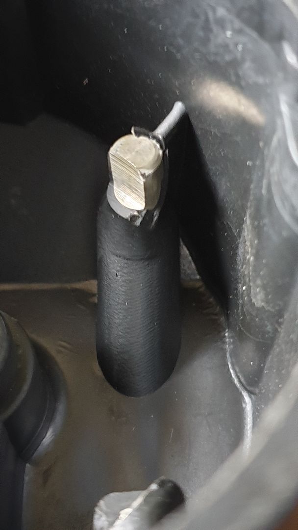

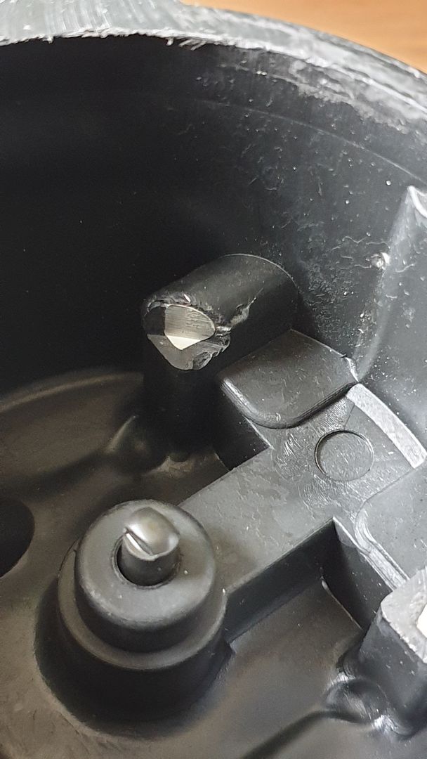

I recently removed the dizzy cap and found the following damage. Upon putting a new cap on and running it at an event, it looks like similar damage is occurring.
I didn't think to check for axial movement I.e. oscillation, but there does seem to be a lot of movement up and down.
I have a spare dizzy and I'll measure that at the weekend but any thoughts would be appreciated.
Looking at those pictures it looks as though the rotor arm is 'jumping' up and down and clattering the cap.
It's an Ambassador cap btw on a powerspark electronic ignition which up until now, has worked faultlessly...I've recently thought that the cap was made from rubbish material but now realise it may be the vertical movement...
