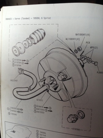

We have two Sprints. One is very early with single line brakes. The other is very late with tandem brakes.
The early brakes are much better than the late ones. Considering the disc size etc, they are surprisingly good. Seems strange that Triumph 'improved' the brakes on the late cars to improve safety by making them tandem, but in fact made them worse at stopping the car.
The only difference is the master cylinder, but I think the bore size is the same.
Has anyone worked out why the late ones are so poor compared with early?

Is it not the simple fact that the later master cylinder shares its pedal pressure over the xsa of two pipe systems, rather than just the one on the single line system and the changes to the master cylinder don't quite compensate for this?

I agree that the stopping power is determined by the force of friction between the pad/shoe and disc/drum. But surely that is determined by the pressure applied to the pedal multiplied by the mechanical advantage from the hydraulics and the servo? And, while I'm not entirely up on vacuum servos, the gain from a hydraulic system is almost all given by the ratio between the bores of the master and slave cylinders.

The ONLY difference between early and late Sprint braking systems is in the master cylinder and in my opinion there is no difference in performance between the two if they are in good order throughout.
So my thinking is that there is something not quite right about your tandem braked car. It is well known (to us at least) that there are distinct pads for Sprints but many factors and lots of ebay sellers will sell "ordinary" Dolomite pads as Sprint pads just because they are the same size and they don't know any better. So I'd go there first, try some proper Sprint pads and see if that helps!

Having used 1500's, 1850's and Sprints, both early and late, as daily drivers I can see where Paul is coming from. In my opinion I always found single systems much more user friendly. For me the tandem system lacks the 'feel' of the single which seems more in line with a modern car, i.e you press the pedal and it feels much more responsive. For me the pedal on the tandem system always felt heavier and braking effect didn't seem to start to take place until you were giving it a hefty shove. I first came across this when I had a late (in the last 2000) 1500HL and a friend had an early one, I always assumed something was wrong with my car, but having had examples of 1850's and Sprints, both single and tandem, I found these the same.
I guess if you drive examples of each back to back as Paul is doing then its far more noticeable as you probably adjust to whichever system you have.
