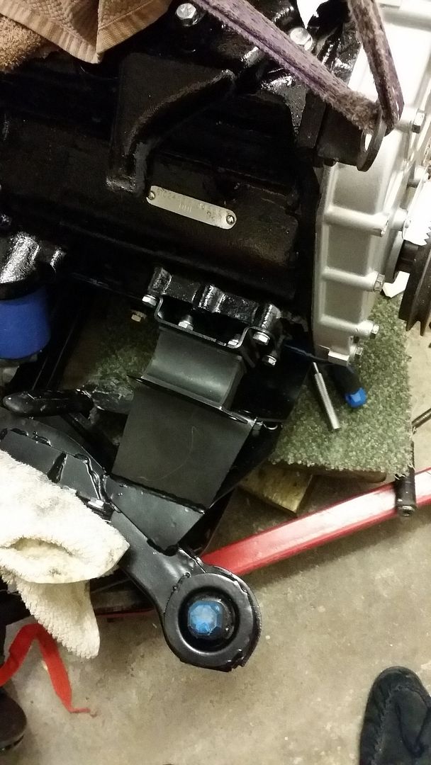

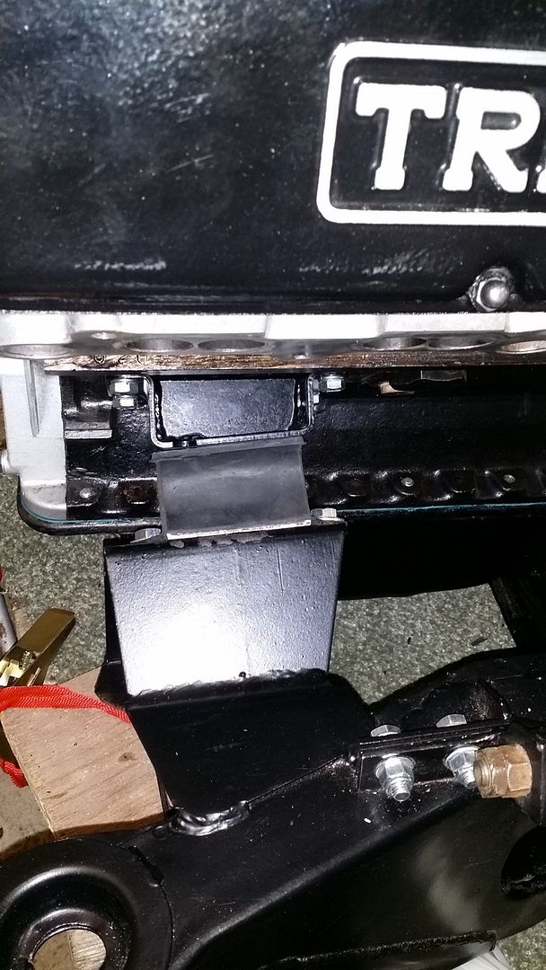

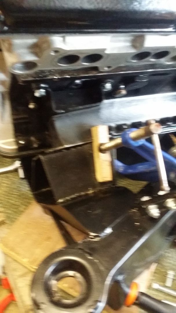

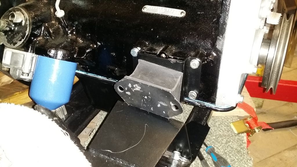

I am having an absolute mare trying to fit my engine mountings.....no matter what I do I just can't get them to fit between the subframe mounting points. It is like they are too wide to fit....I'm pretty sure the brkts are on the correct way round.....have a look at these pics and then please tell me that they're on backwards/upside down/back to front/ are off a Messerschmitt bubble car.

According the workshop manual, the driver's side engine mount should be fitted first.
having said that I have fitted mine according the WM but I am still having trouble getting the other mount to line up.
Jon Tilson recommends using oil between the sub-frame and the mouint to help alignment.
best or luck
malcolm

Tried fitting the rhs first and couldn't get the lhs to line up and then tried what you see now Malcolm.
As far as you're concerned then, they're the correct ones on the correct sides etc. then?
I'll have a go with the oil tomorrow....

The general guidelines are that the semi circular cutouts go at the top. You have that.
Looking at your pics it seems to me that the nearside bracket is too deep and not tapered.
Are you sure its the one that came with the car?
These are not much fun to get in place. It always takes me a while to get them in...so a bit of grease on the rubber to subframe helps
and a long screwdriver helps to line the holes up poking through holes in the subframe on the n/s.
Reg

I have just measured a few mounts and they vary between 45-47mm. that's just the mounts not the brackets. Bearing in mind these are old ones so may have compressed a bit. Your brackets are in the correct locations.

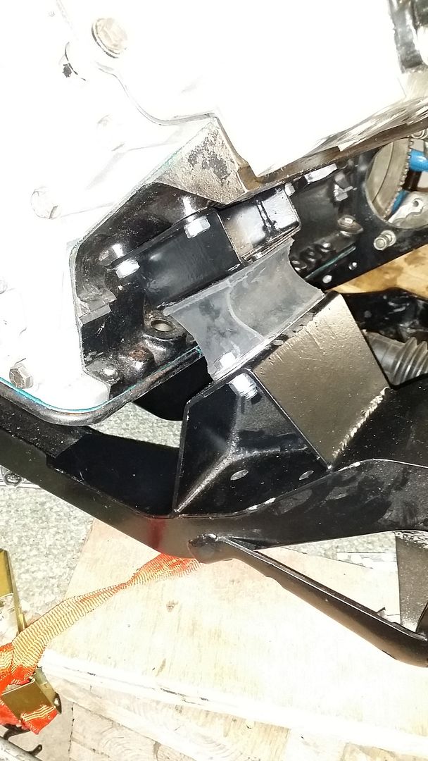

Phew, done it! That was traumatic!
It was comparatively easy in the end as once the off side was in I 'just' used the clamp to push the nearside rear bolt hole down until it lined up and then popped the bolt in.
To get the forward bolt in was trickier as the top of the bush needs to be slightly lower than the top of the subframe so I had to put a special aligning tool (a kitchen spatula) in which pushed the top slightly lower.
Took about an hour and a half from start to finish this morning as opposed to about 6 hours of failure yesterday.
Apologies for the crap pictures....

Ah it must have been a perspective thing in your earlier photo. That one shows the bracket tapering.
Glad it went in ok in the end.

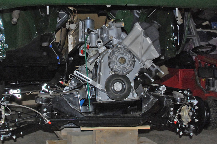

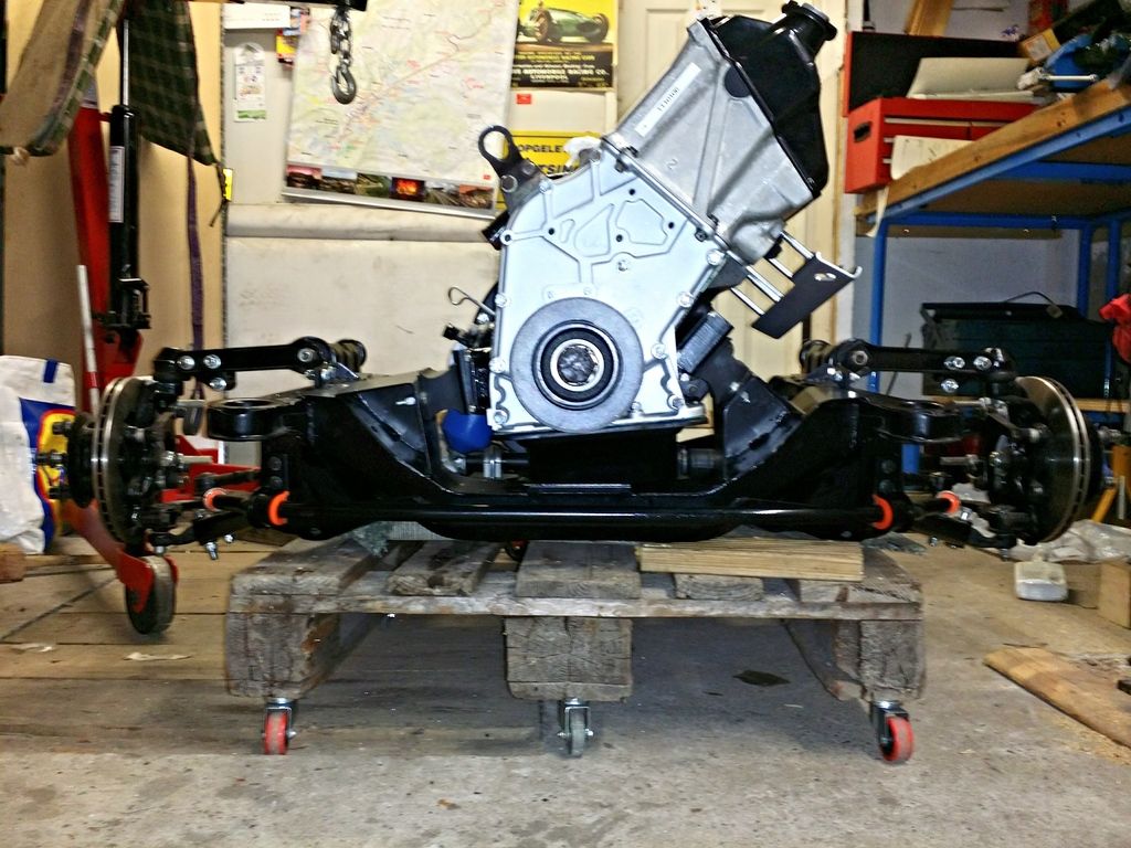

Fitted the front ARB and gearbox tonight, and looking from the front of the engine, the engine seems to be canted over to the offside....is this normal? Should the engine sit parallel to the subframe?

That all looks pretty okay to me.
I have gone back through my photos to see what I can find and here is one of the engine and subframe assembly as I rolled it back under the bodyshell during its installation.
20120926-3571Pw Sprint subframe installation.jpg (199.64 KiB) Viewed 1912 times
You will see that the engine has a definite cant over to one side, that the sump pan does not sit "level". I can assure you that everything just drops into place when the body is lowered although it is very tight around the bolts which hold the exhaust manifold onto the side of the cylinder head.
I have removed and reinstalled my engine on numerous occasions since this photo was taken and on subsequent installations I found it was possible to lower the body shell over the subframe assembly with the radiator in place and with the alternator and fan also fitted.
Robert

Mine engine is also at a similar angle to yours..looks fab. :)

Gentlemen, thank you very much indeed: that has definitely set my mind at rest!
Because of the trouble I had fitting the mountings, I was convinced there was something wrong with the rubber, like it was manufactured incorrectly or I'd got them on wrong.
