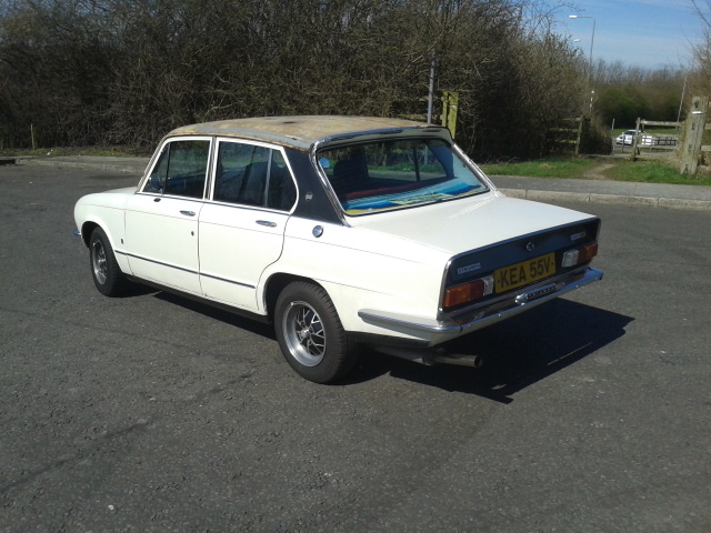

The main problem which I have not come across, that the roof is coming away/ parting from the back above the rear window body work . He says this is common as has the piece to splice in, welding is no problem for me? The rest of the body looks good, bubble here and there, mot'd and the back mot's on line gives it a clean bill of health no welding for the last 5 mot's.
So my question is is this common for the roof to part from the body above the window.

The roof vent panel does often sadly suffer from corrosion where moisture creeps in under the trim and vynil.
Repair sections have to be found from donor cars sadly or you need good fabrication skills to patch it up.

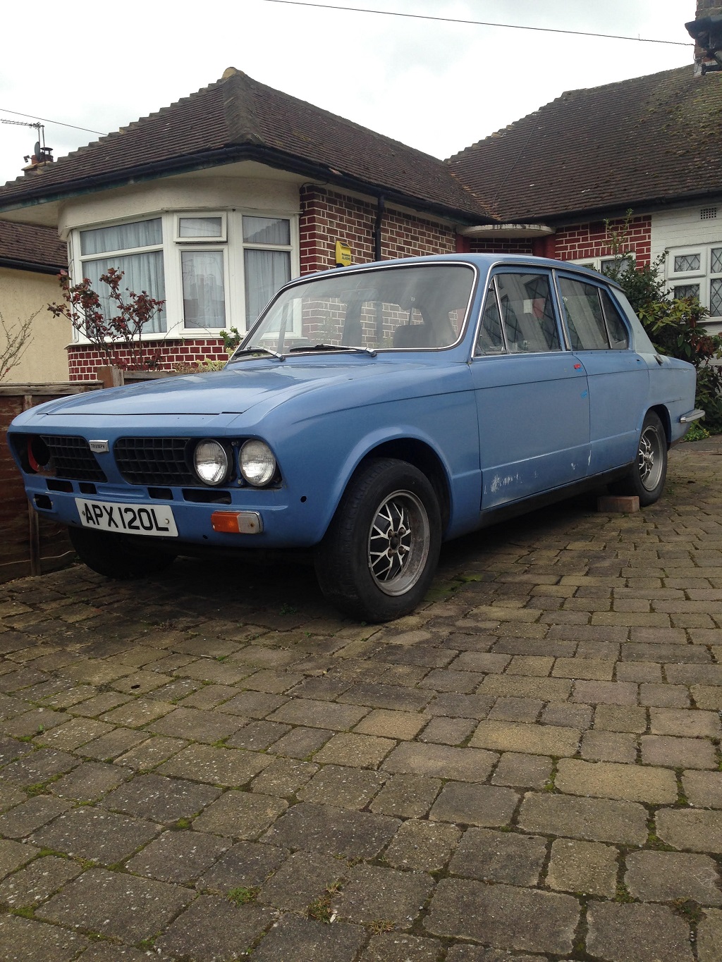

Hi Many thanks for your comments, this is going to be quick learning curve, the 1850 blue my sons - the dash, the one that is in there does not have chrome outer rings where the one that was given as an extra to my son has? I haver seen 1850 without head rests and this one has so these must of been added later? I have been advised by his driving instructor, while he is still learning and for his 1st car it must be a manual, so that he can learn to drive a manual, if he goes straight to a auto after passing his test then he could loss the experience/knowledge he has gained in the short time of driving of how to operate the gears?
I think I have loaded couple of photo's of each? seem to be solid underneath, but I will not know until I start crawling underneath and start poking around, not looking forward of getting the rust etc in my mouth ears hair etc, I think we have all been there lying on a concrete floor.

- 1850 side.JPG (218.79 KiB) Viewed 5316 times
- 1850 .jpg (565.66 KiB) Viewed 5316 times
- roof of sprint.jpg (151.36 KiB) Viewed 5405 times
- sprint .jpg (144.47 KiB) Viewed 5405 times

Your blue one APX is quite an early auto so may well have had the older type face clocks with black bezels and stromberg
carbs when new. If the chassis number is below about 22000 it would be like that originally.
As Matt says this is quite a rare car and I would say should be kept as original as possible being an early one.
The diff ratio will be wrong for a manual and not helpful for a learner driver. On a 3.27 diff you would never get out of 1st gear and hill starts would be "challenging". Even on a 3.63 diff a manual dolly will do 40 in 1st gear.
Can I suggest you get yourself a manual 1300 as well for learning and keep this one for yourself as a later "original" project. I'd lay odds you will eventually love it more that a Sprint....
