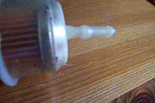

Re: Tickover or Rev - culprit(s) found
Turned out the main culprit was a bent filter (see below). I am getting a metal one.
However when I was setting the carbs up again, one of them would not lean out , that turned out to be a blocked vent in the float bowl.

- filter.jpg (30.86 KiB) Viewed 745 times
