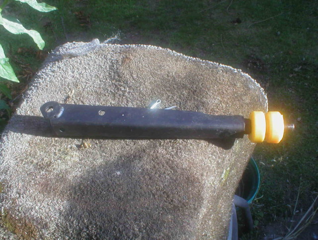

In this box of bits I also have a Dolomite front tie rod.
This one even looks brand new. It has 2 bright yellow Supaflex type bushes fitted as well.
Now have a look at the piccy and spot the difference......
Yes, there is no hole for the "R-" clip.
Is this a late one designed for a nyloc nut or something ?
Or is it Toledo / or an FWD variant ?
Thanks very much,
sprint tierod.jpg (129.66 KiB) Viewed 1072 times

Suspect the end threaded bit has been replaced as they tend to wear.

#3 Post by sprint95m »
T2000.
(Yes these used a nyloc nut.)

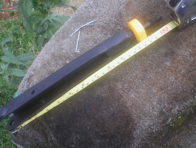

best check the length then Tony...

I've measured it up and have the following :
Lower suspension bolt-hole centre to ARB link hole = 75mm
Ditto to back face of the rear polybush = 262mm
Ditto to end of the threaded section = 318mm.
If this a T2000 part I'd be happy to swap it for an 1850 one.
Same as Sprint I think.

have a look at Tony thread viewtopic.php?f=19&t=25122#p241127 regarding those front tie rods - last picture in the first thread posting.

Thanks all for your comments. I found an old one and compared it and yes, it is a Dolomite item. I just need to drill the hole in the end for the R-clip now.
