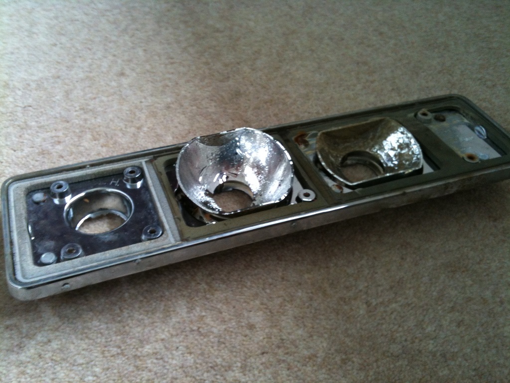

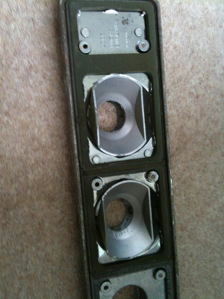

Meanwhile I am starting to go through the 'bits'. Most look in decent condition, especially the interior. I thought I'd start on something simple such as the rear lights, and immediately came up with a question for the forum. I've posted pictures of two rear lights, one came with the car, the other I picked up for a fiver at Beaulieu. The original has plastic reflectors that were shiny silver but most of that has peeled away. The other one has reflectors that look like they are just painted silver, and are not at all shiny. The silver paint may or may not be original, but would be easy to redo, whereas the shiny silver is not a simple process and costs a fortune. Can anyone say what their car has, and any suggestions welcome!

I've resized the photos. You should be resizing them before you upload them or better still, host them on a site such as Photobucket or Flickr. You could try some chrome paint on the reflectors. I think you would be better off finding some better condition light units. I have a couple of spare light units you can have. I don't know what condition the reflectors are but I'm sure they're better than what you've got. The single best thing you can do is to join the Club. The membership fee is worth every penny.

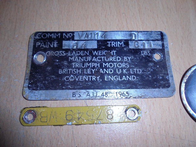

All us early Dolly peeps are wandering..... What is the VIN number?
Looks mimosa painted vermillion so could be very early.

Are you happy to refurbish the reflectors on lights where the metal surround is pitted (which I believe can't be remedied)?
Are you looking for originality? If so, you'll need to establish whether your car should have chromed or painted reflectors and repair or replace them as appropriate.
Are you concerned about lighting efficiency? If so, you may wish to consider converting to LEDs, and I believe another thread suggested that gloss white works better as a reflector, better even than the chrome finish.
As an aside, does anyone know whether replacement seals are available for fitting the back lights (and the front indicators) to the body, as these often compress, harden, crack or otherwise deteriorate with age? Alternatively, does anyone know whether suitable material (closed cell foam?) is available to cut replacements from?

Jeremy, you're right in that LED bulbs work better with white reflectors. Also, it is better to used coloured bulbs with stop/tail lights and indicators unless you use warm white LEDs which have a similar light to filament bulbs. If you use bright white LEDs the colours through the lenses look a bit washed out. Also, you will either need to fit a suitable indicator relay or use load resistors if you're going to use LED indicator bulbs.

Toledo man - Thanks, I would certainly be interested if the reflectors are good condition and the shiny silver type. The rest of the lights are not bad. I hope to refurbish as much as possible rather than replace - that's my thing really! Unfortunately I have been quoted £80 per reflector(!!) to re-silver them!

Polly B - Well the V5 says VA1114DL. The chassis plate is a bit unclear - it could say 1114 or it could say 114. The previous owner got a heritage certificate for 114, but I'm not convinced. Unfortunately the engine doesn't appear to have a number on it (I'm told this is not unusual) so I can't compare that with the V5 or the heritage certificate. There is some reason to believe the mileage of 28K, so I'd hope it's the original engine. I know about mimosa and the first 2000 cars - not sure about vermillion though?
Pippin - See links above for seals. I do want to keep t as original as possible, but I am willing to compromise if necessary. I don't want to spend £80 per reflector! What you say confirms my suspicion that the extra lights I bought must be from a later car and they had changed to (probably cheaper) reflectors. The lamp bodies are also different, they are diecast but to my untrained eye the earlier ones look steel. Might consider LEDs if it's a straight swap. Interesting about white paint, I'll look into that. I also read a suggestion about using silver leaf glued on!

You have one of the golden 1st 1500 or so that were all painted mimosa yellow for homologation purposes.

Here's a pic of the chassis number, the second 1 looks like an afterthought, but must be deliberate, so I'm inclined to go with 1114. That's still early enough!

Regarding the rear lamp reflectors, paint them a bright gloss white as white reflects light something like 60% better than painted silver.
I painted the reflectors on my Spitfire in Plasticote Appliance White which worked a treat!

Thanks Howard. I may well do that. Toledo man also said white works well, especially with LEDs. I've decided to go with LEDs for the rear lights at least.
I'm amazed how well the chrome on the later lights (second picture) has polished up - not quite like new but with a lovely period look. The original ones look better to start with but have corrosion that can't be polished away.
