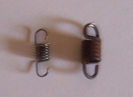

New springs are available from Robsport.
This is interesting, I bought new springs from Robsport some time ago. I have managed to get hold of some original ones, they are much more substantial than the Robsport ones (see below). It says on the Robsport site that you need 2. I wonder if they mean 2 per weight.
