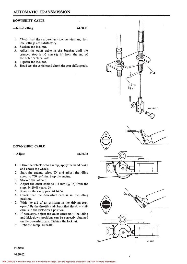

You need to adjust it until you have a 1.5mm gap between the threaded part of the outer sheath and the crimped stop on the inner cable. I can post the relevant page from the factory workshop manual if it will help.

Check the condition of the fluid. It will tell you the general condition of the transmission. If it is cherry red and doesn't have a burnt smell the transmission should be fine (Harvey will know better than me so I'll bow to his superior knowledge). Here's that page from the factory workshop manual on adjusting the kickdown cable.
