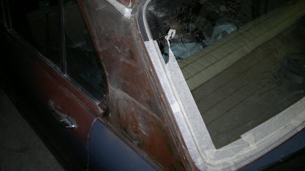

When I took mine off I didn't find any serious grot. You don't need to disturb the headlining but you will need to remove the chrome trim from around the rear window, the D-post badges and the furflex trim to get access to the vinyl. Mine came off in one piece but they're a bit stiff. I'll be putting them back on eventually but in the meantime I've painted the D-posts with satin black to cover the primer that I'd put on. This is what mine was like after I'd taken the vinyls off.

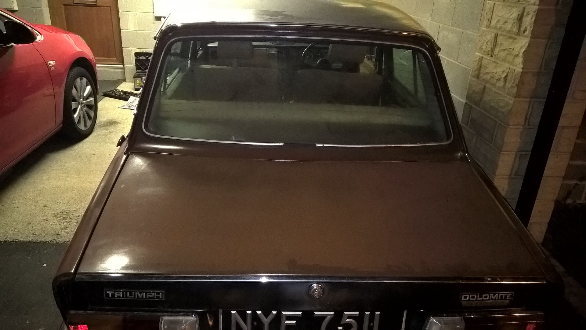

No need to touch the rear window. The edge of the vinyl is covered by the chrome trim. It doesn't go anywhere near the glass. This photo of my rear glass shows it better.

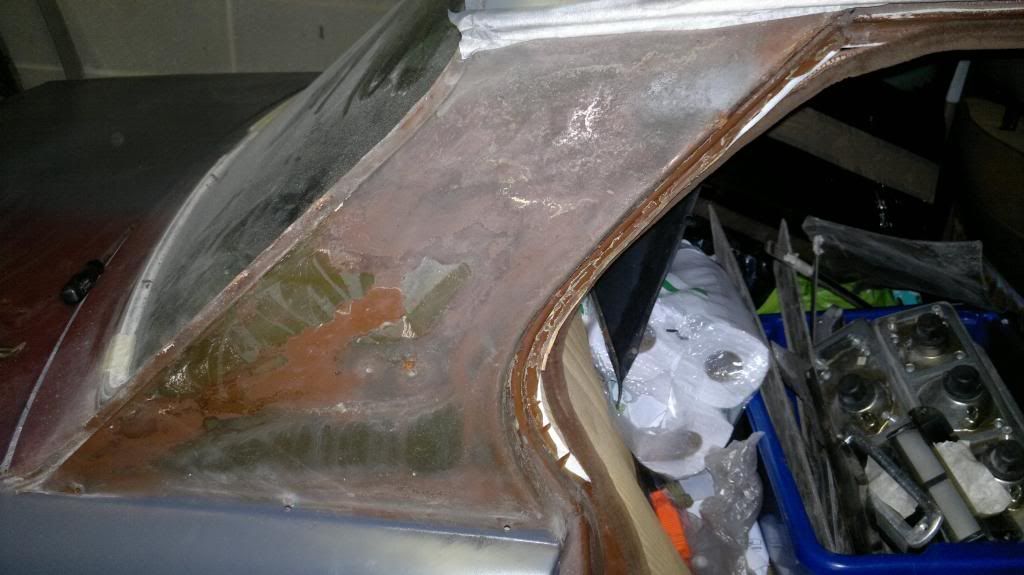

Under my vinyl was a LOT of rot, particularly at the bottom where the holes for the stainless trim securing clips were, and at the rear under the chrome trim on the offside.
It's been cut out and welded on one side, cut out and fibreglassed on the petrol tank side.
I have a repair panel for welding in 'some time in the future'............
