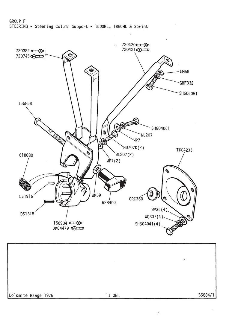

This is the page from the post-76 parts catalogue.

You need to knock the cottle pin out DS1318 - this will allow you to remove the long bolt 156858 once you have removed the black handle 628400 then the column will drop allowing you access to the steering cloumn clamp to check to see whether the spring is there. Be careful as if is there it will ping out whilst your drop the column.
When you are refitting it make sure the machine slot or groove in the threaded bolt aligns with the cottle pin hole - if you dont the pin won't slide in all the way.

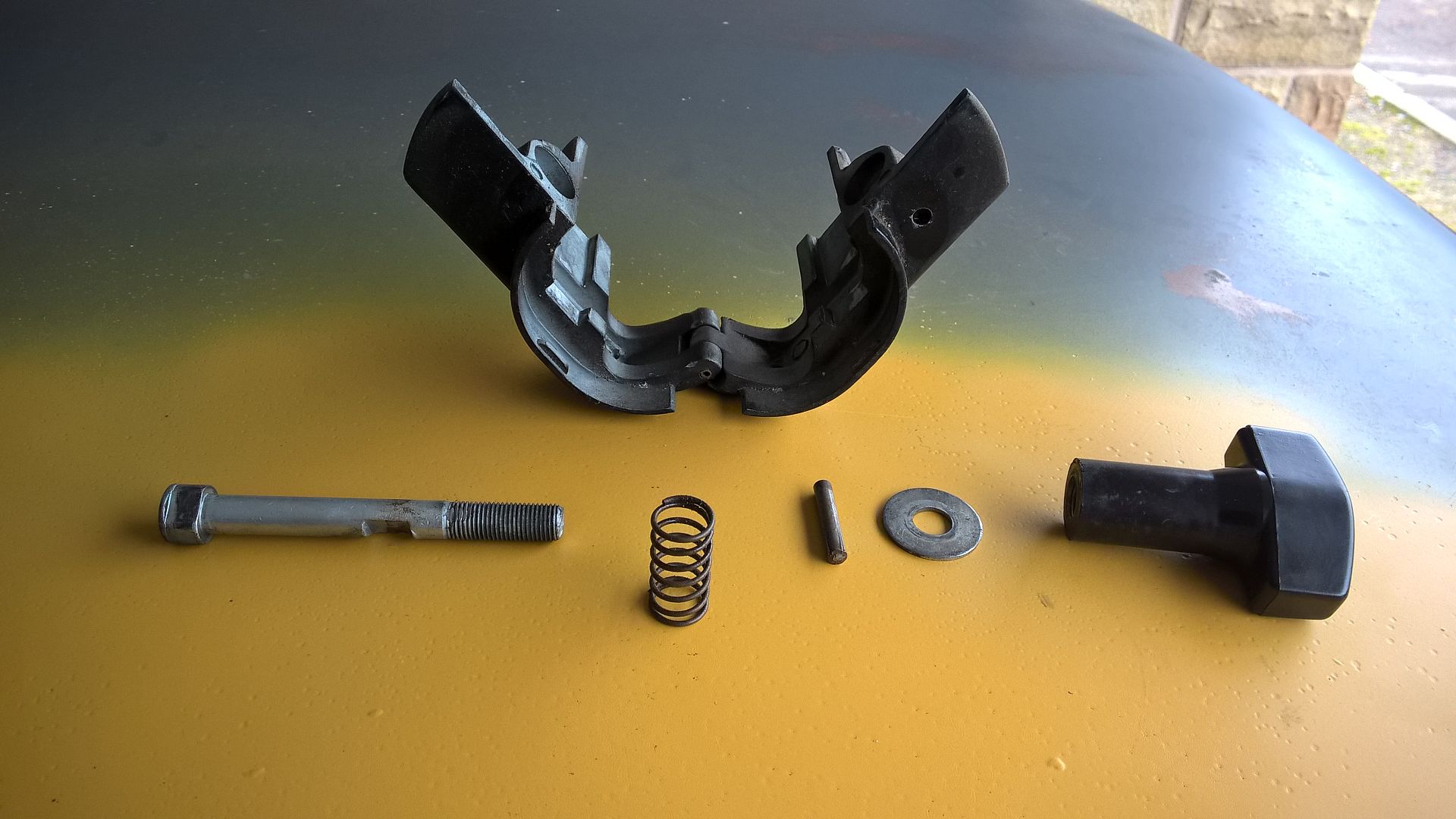

Matt, you were right! It needed more than 1 washer.
I bought a centre punch set from my local Toolstation and the pin came out without any difficulty. When I got the clamp off everything was present and correct.
I painted the clamp while it was off and I noticed that the wire for the indicator stalk was incorrectly routed so I ended up dismanting half the steering column to get access to the parts so I could correctly reroute the wire. I reassembled everything and I used 3 washers with the adjusting handle and it clamps up nice and tight. Success!
James467's recent work on his steering column in his resto thread was a big help to me in making sure I'd reassembled everything correctly.
