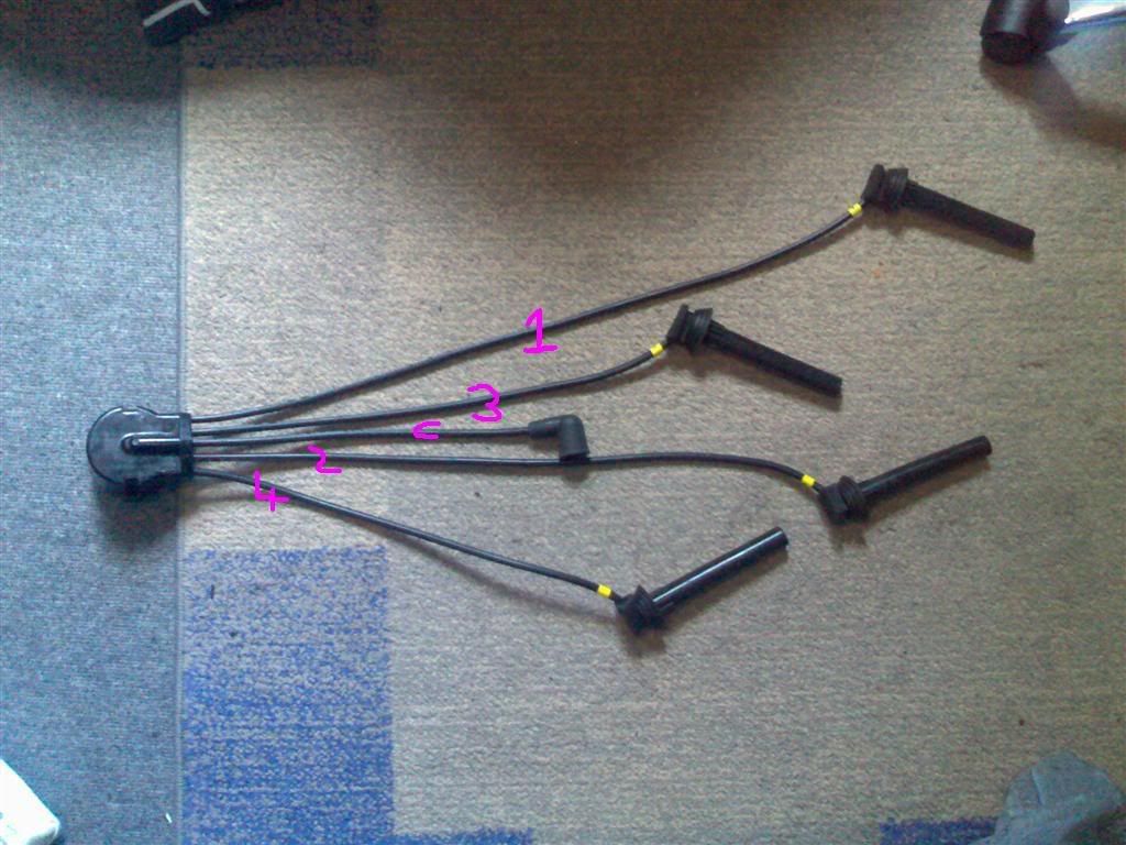

checked it. there all sparking
i have the plugs in order.
3 looks a little weak. adjusted the gap hers a pic of my cap and leads.

by Mad Mart » Sun Jul 08, 2007 4:19 pm
That's the correct order James as long as you moved the dizzy so that the rotor arm was pointing to the lug on the dizzy body when no. 1 piston was at TDC on it's compression stroke, I'm pretty confident you did that.

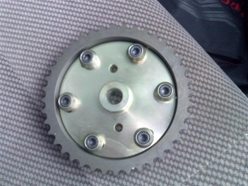

by knightrider150 » Tue Jul 10, 2007 8:49 pm
look what i got today.
this is going on tomorrow night

Nice one James...just like mine.

would you agree with that the cam timing is a bit out? its deffo sparking on all 4.

by 2F45T4U » Tue Jul 10, 2007 11:44 pm
How do you know it's timed up properly? Are there any markings on the sprocket or do you do a bit at a time until it runs best?
