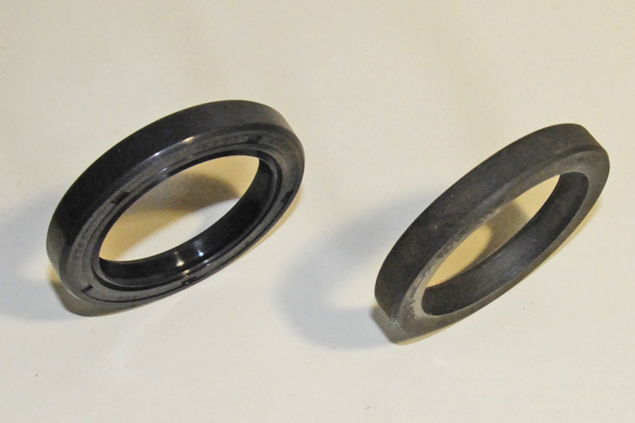

Has anybody had any experience of substituting a double lipped oil seal for the single lipped seal UKC 3344 described rather quaintly in my parts book as a “seal, fan bearing housing, engine” the front crankshaft seal.
20151017-5507Pw Double & Single lip front crankshaft oil seal.jpg (190.19 KiB) Viewed 780 times
The photo (unfortunately not up to the superb photography standard of James467) shows a new double lipped seal which I have purchased locally on the left and an old, (reject) single lipped standard seal on the right.
It is my intention to drop the engine and sub frame assembly out of my car and in doing so sacrificing both the existing coolant and brake fluid so that I can attempt to remove the existing oil seal by removing the bolt 156499 which holds the front pulley on and then removing the front pulley. I suspect, and I hope, it will be relatively easy to work the existing seal out of the timing cover and replace it, without disturbing the timing cover itself.
Robert

I took the bull by the horns, so as to speak and dropped the engine and gearbox assembly out sitting on its sub frame as I have done numerous times before and replaced the front seal with the double lipped seal as shown in the above photo. And, acting on the advice given by Jonners, packed a little grease in between the two lips of the seal as well as ran a smear of grease around the running surface of the crankshaft pulley on which the seal runs.
The original seal, and I suspect it was the original factory fitted seal, had worn so much that it had created a nicely polished surface, nearly as wide as the seal itself. So there was no need to polish the running surface on which the two lips of new seal now run.
The old seal just popped out when I put the blade of a screw driver under it and levered it back over the nose of the crankshaft. No drama at all in extracting it for once the crankshaft pulley is removed there is ample room to grab the edge of the seal with the screw driver blade.
Unfortunately as the old seal failed it allowed oil to come out onto the back face of the crankshaft pulley and it was then spun off the pulley and the air passing through the radiator and fan then coated the entire engine assembly with a fine oily mist, The engine now does not look like the near spotless engine it once was. If only I had an old fashioned steam cleaner I would give it a quick blast and restore it the shiny state it was originally.
The new twin lipped seal seems to be working perfectly satisfactorily. Sadly I will not be around in 40 years from now to report whether it performs any better than the seal fitted originally.
