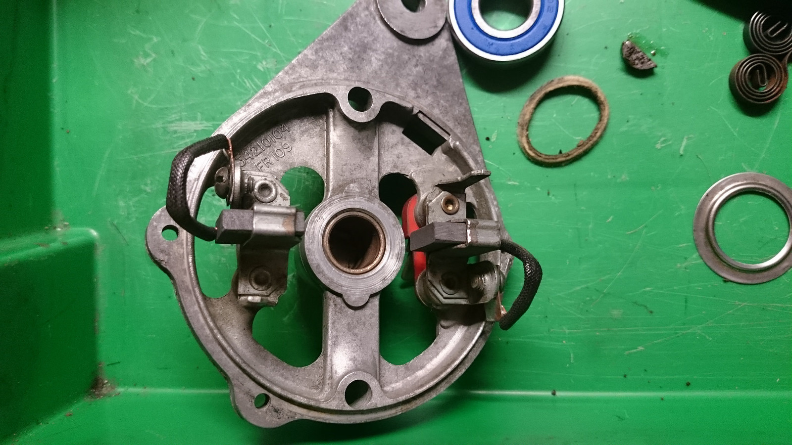

Looking at the below picture I trust all is correct, less the brush springs obviously.
Should there be a link wire between the left and right brushes, there wasn't originally.

I don't believe there is a link lead, and I repeat that the car should be negative earth!
