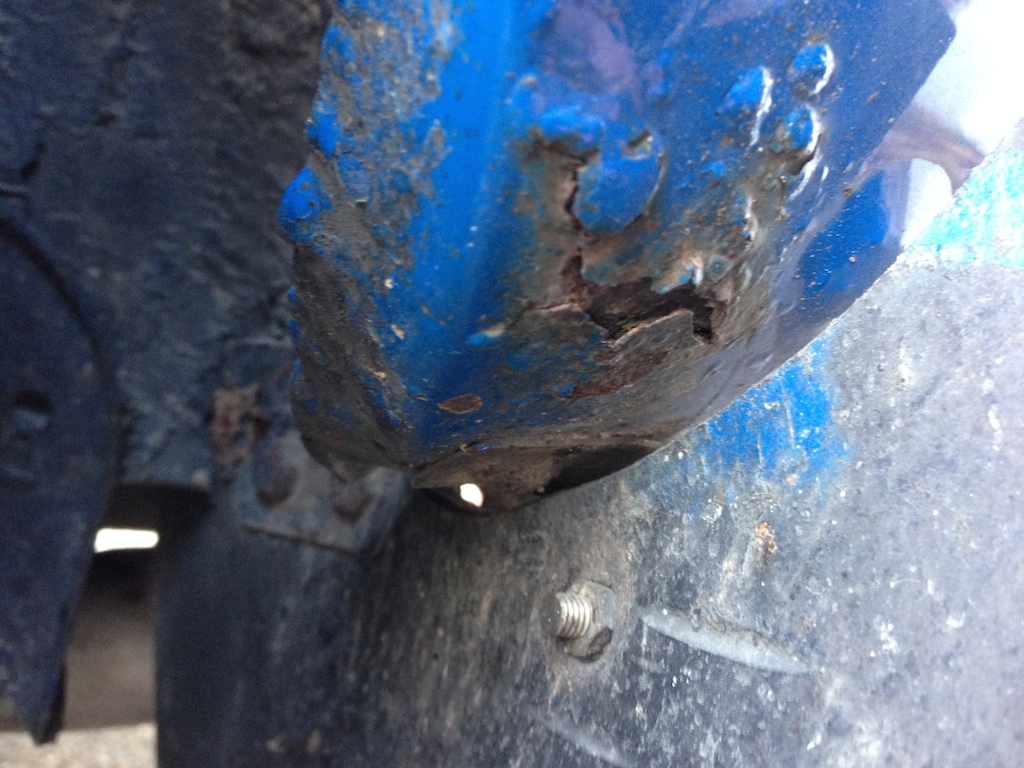

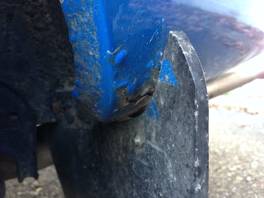

I have some rust bubbling in that spot behind the LH rear wheel (in the vicinity of the fuel tank), and I’d like to get it fixed. My local old-car body shop is willing to fabricate the patchwork, which shouldn’t need to be very large, given how small the rust spot is. But if the pieces available from Rimmer are any good, he’d rather start with that than from scratch.

Does anyone know if the rear-wing patch panels from Rimmer are worth a darn? Part number RT1239 is what I’m eyeing … http://www.rimmerbros.co.uk/Item--i-RT1239

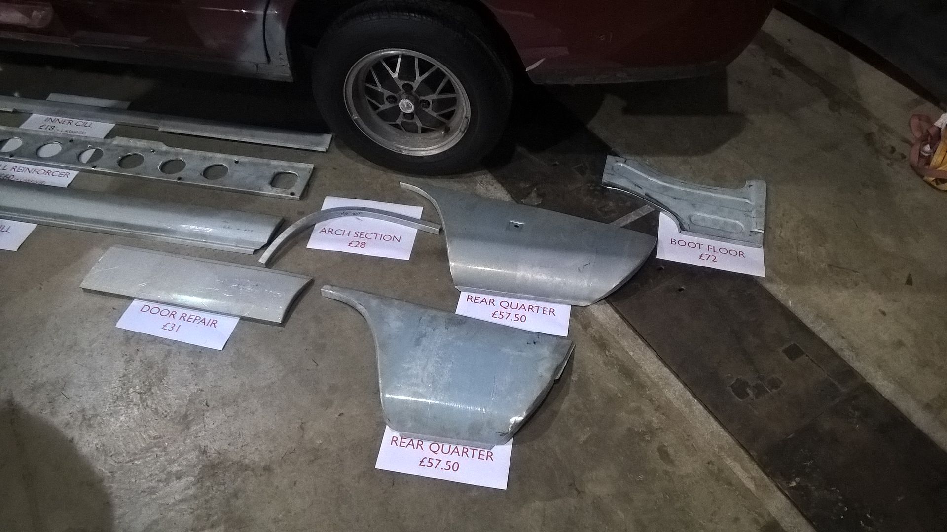

You need to join the Triumph Dolomite Club as Alun Nicholas has had similar panels manufactured from Zintec steel for club members at a cost of £60 each. I anticipate Alun will respond with his email address and/or telephone number when he reads your post.

Joining the Club is an absolute must and worth every penny. It might be better to just fabricate a repair section but the Club do offer the repair section.

I can't comment on the Rimmers repair panel, but maybe fabricating a small section could be a good option. It might depend just how extensive the problem really is. I always seem to find more underneath.

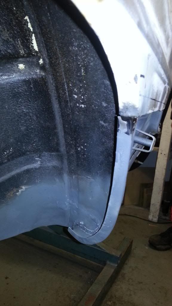

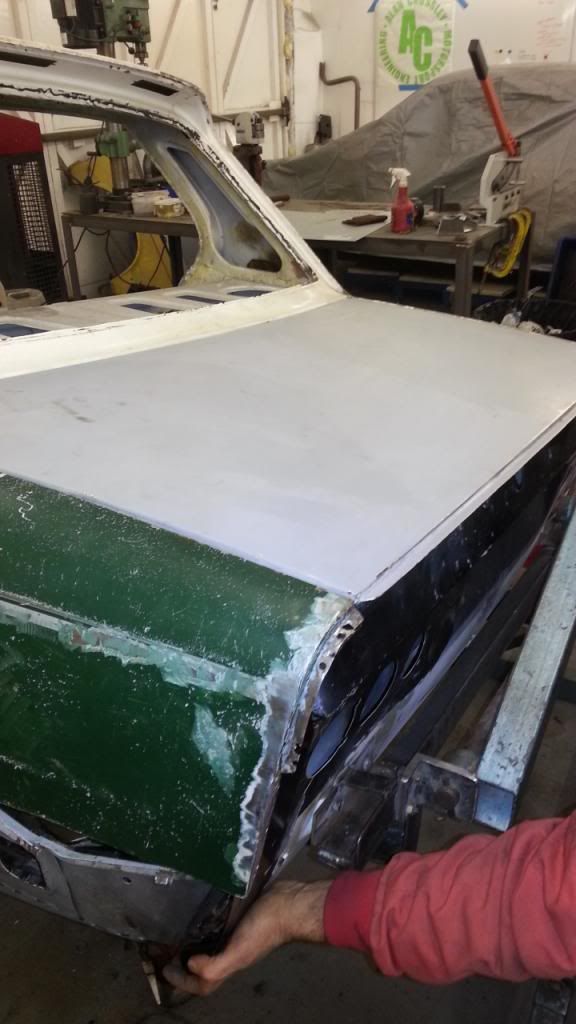

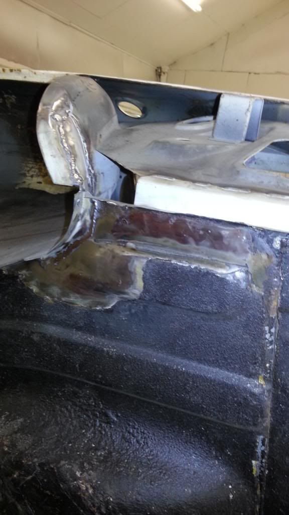

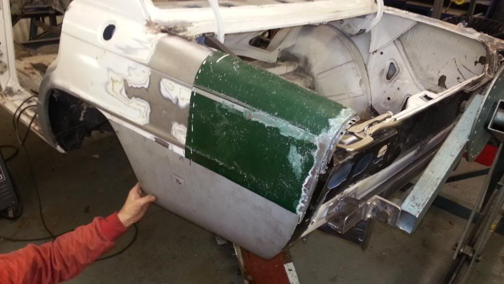

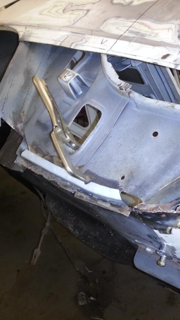

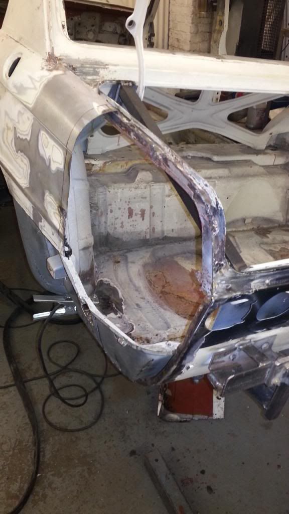

I can definitely vouch for the club repair panels, we used them to repair both rear wings on my car, as can be seen below.
the club repair panels are the grey coloured ones(if that wasn't obvious already)lazeruspete wrote:hello again!
more piccies
plate to replace the missing bit of the inner arch in the boot
getting there....
bigger hole!
if you squint it looks like a dolomite!
bootlid put in to make sure everything is the right shape...
hope to hear your opinions!

Thanks for the advice, everyone—and for the warm welcome! Gives me some things to consider ... and some informative photos to share with the shop.
