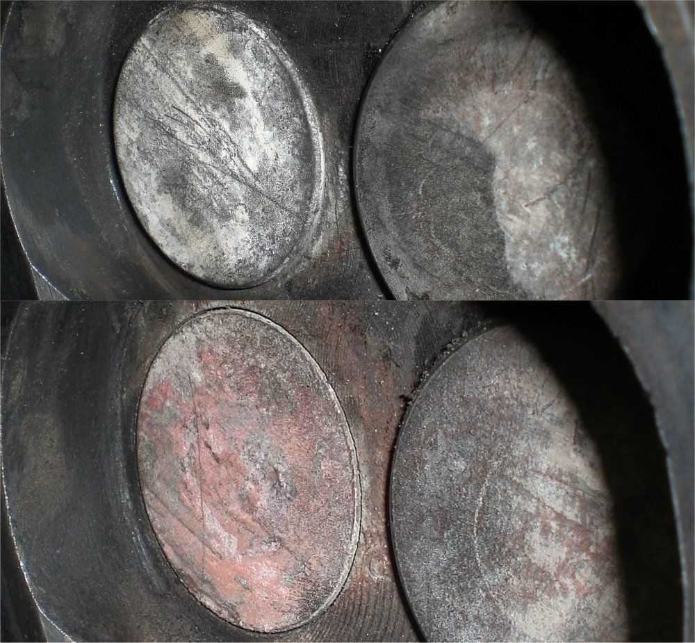

Re: Valve recession - How much of a problem for the 1500 eng
These were taken 06 Oct 2007 (yikes) when the head was off to replace exhaust no 3. That's the replacement at the top and is quite badly recesssed, below is exhaust no 1 which as you can see is tunnelling it's out of the engine.
The head went back on and covered another 6000 miles until the engine came out at the end of Jan, I'd sourced an O/D box from Tony in Blackpool. That came with an engine and due to the above plus pretty poor oil consumption the 'new' one went in. Still, in those 6000 miles it returned 35.36mpg on the Horley <-> Bracknell commute.
That head had done 29k in 22 months for me. When it went on it was of unknown age, had sat loose for who knows how long and got zero love & care before it went on beyond the basic level of decoke you can see I've repeated in the above.
IME no1 is always the worst, the replacement head always needed more adjustment same as this one did. Biggest surprise for me in this respect was that when I fitted Britpart ignition the valve recession reduced hugely. Before I was backing the adjusters appreciably every 3000 miles, after I was leaving it longer, probably 6000, and backing off much less each time.
95 unleaded and no additives.
