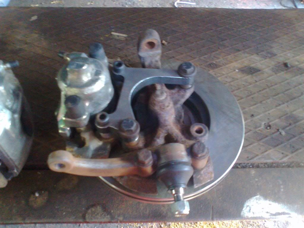

Trackerjack Jon has been having some health issues recently, we all wish him a speedy recovery! Until then the supply of TJ conversions may be a little curtailed!
The calipers and carriers used are Sierra, which are now getting hard to find but there are other Ford calipers and carriers that have the same dimensions. I have just liberated a pair from a scrap 1700 Puma that I had lying around and am going to try them on some hubs in the near future. I believe some Escort ones (mk 4, 5, or 6) will also do the trick The discs are Golf vents, 230mm IIRC redrilled, machined out in the centres and with the hub face thinned slightly. I had some flexies made by Goodridge to go between the standard imperial hose and the metric caliper. I have a couple of spare sets but they are not quite perfect in design (my bad) and require relocation of the support bracket to fit.
Kit as fitted to my Toledo
The Top pic shows the assembly fitted inside a Sprint alloy. You can also see my mod hose and how it needs to be mounted, not TOO far off original!

I'm not sure TJ kits have a fixed price, I have bought 2, neither from Jon, 1 was £120 without calipers or carriers and the other was £180 with a pair of recon calipers and used carriers. This second set was obviously better value since the calipers are roughly £50 each exchange here.
From what I can gather, the Sprintpart kit is complete and ready to fit whereas the TJ kit needs the buyer to do some work on the retained original parts.
Since Sprintparts is already in OZ, it might actually work out cheaper to get their kit!

Also thank you Steve for your pictures and yes the brake pipe set up looks good, that was always on my mind going from UNF
thread to metric if using ford calipers.

Well yes its around $720 dollars but post is $300 dollars. so I make £362 for the conversion and £145 for the delivery.
Plus any tax that they feel should be added on this end. So the jury is still out on this at the moment.
Also Sprint parts are updating their conversion in 2016 to a 4 pot caliper and I have asked why and the benefit of that choice.
On a good note sprint in know in paint shop and I will be bring her home soon.
I have also order my vinyl form Martrim and that is being dispatched today £120 for roof material and D posts.
I also wanted to ask Jon about his B-----s rubbers did he get the chrome expanding trim to fit because I could never get in.
ok must go and thanks again for this debate cheers gary.
I must admit I'm no rocket scientist but I tend to go on word and mouth in many cases and I think
Steve has summed it up. I don't hang around and yes I have had the pedal dropping away also.
I have been talking to sprint parts in oz and been talking about prices.

I have had a reply from Sprint parts and they are changing the calipers on their brake kits.
This is due to the fact that the calipers they presently use are getting very difficult to obtain. The new calipers are lighter and
will fit inside a std sprint wheel with out modification.
They also said the new pad size is 15% bigger than sprint pad. Once again this can wait till next year.
