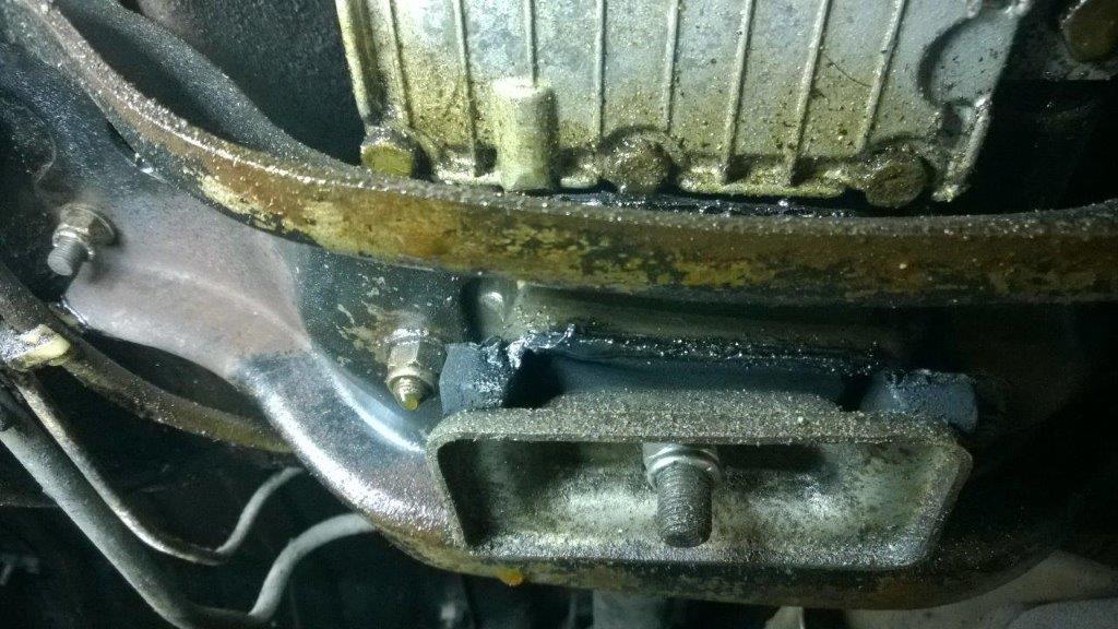

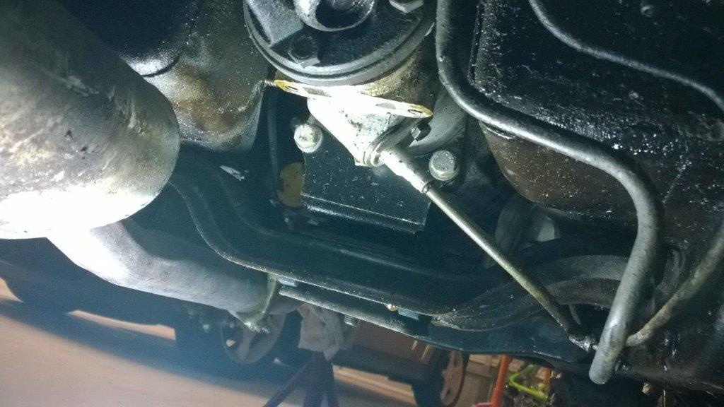

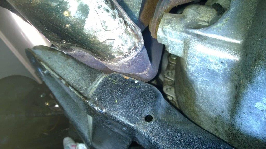

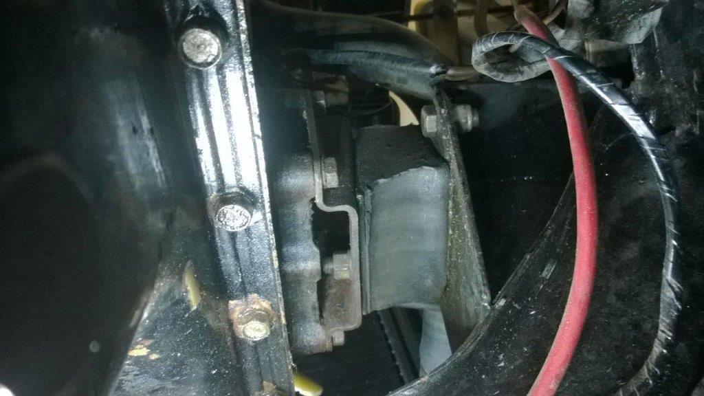

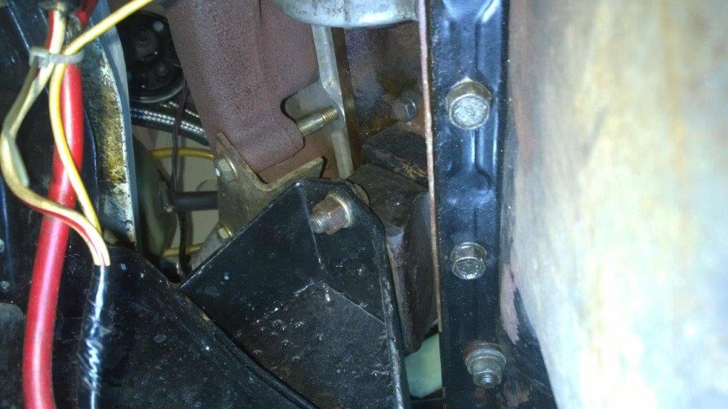

Re: New vibration after recent work
See here first : viewtopic.php?f=4&t=32294

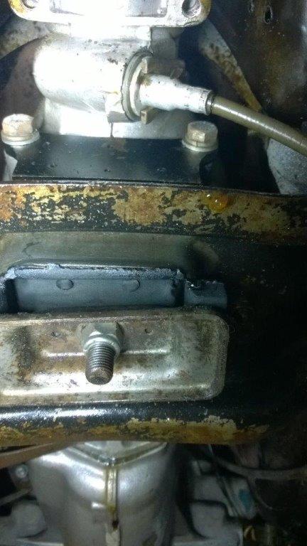

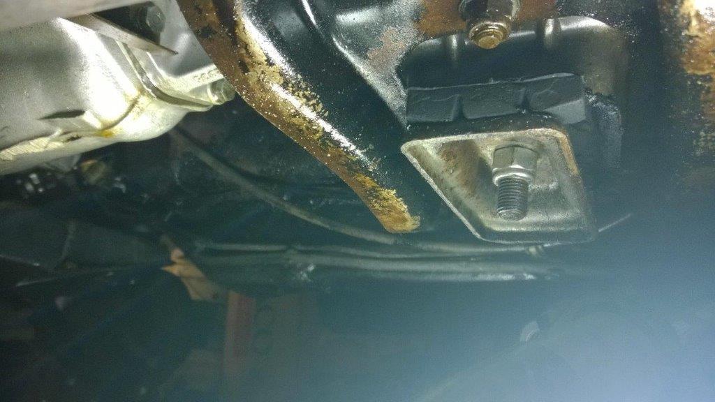

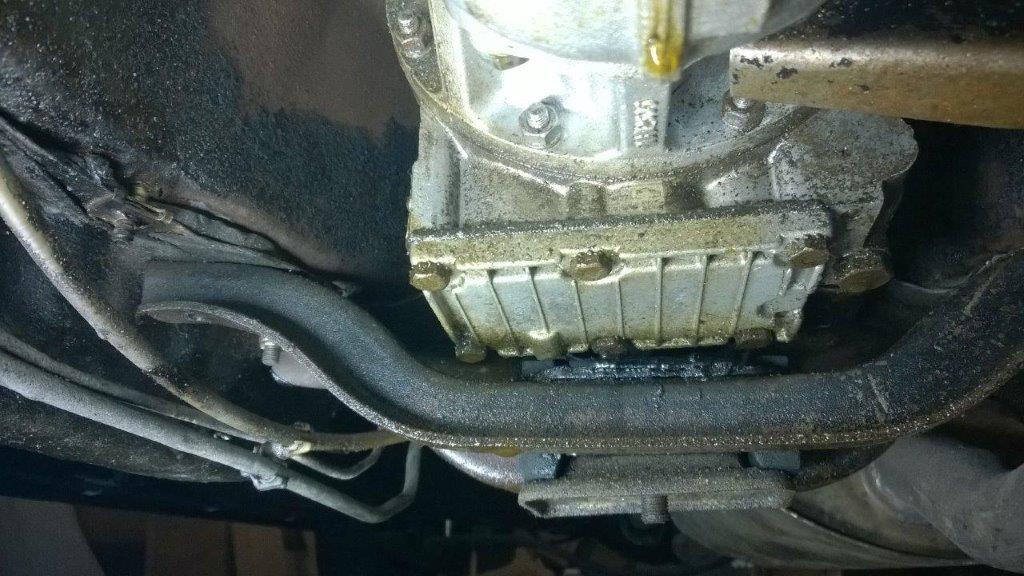

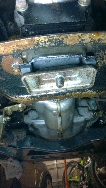

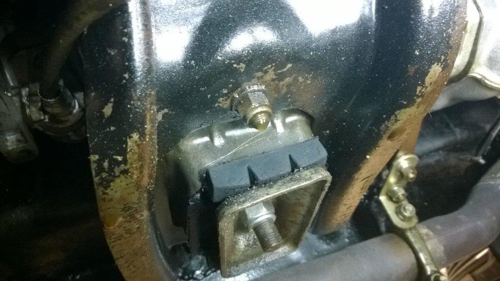

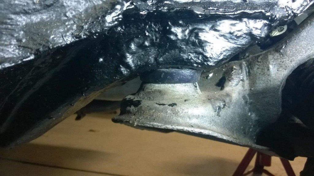

Time has moved on and if anything the issue is worse.
The engine runs reasonably smoothly and as far as I know the exhaust remains good, at least externally ie its not blowing.
The noise at certain revs - lower revs mainly - is fairly unpleasant. It's noticeable outside the car but isn't too bad. Inside the car it's very noticeable and annoying. I was under the car again yesterday and took some pictures. It feels fairly obvious to me that its caused by the exhaust downpipe hitting the subframe. I'd commented before about the downpipe having been modified to clear the subframe is the first place - something I wasn't too thrilled about at the time.
Now though I just feel sure it's hitting the subframe at certain revs - worse around idle and better at speed when perhaps the engine is running more smoothly.
The question is why has it got worse. There can only be one of two causes as I see it - either the drivetrain is lower or the subframe is higher. The last work I did was to repair a split subframe bush. On doing this work a couple of unexpected issues popped up - one was the issues of the spacer tubes mentioned above and the other was that while basically sound there was some rust around the mounting points.
I cleaned all that up and fixed it with liquid metal. I know that's kind of a bodge but it was basically sound and I didn't have the time or the money to get it to a workshop for a load of extended welding. The net being that the position of the large washers inside the engine compartment might be a little more raised than before .... but of course that is not going to have any effect on the issues we are talking about. Might the mounting beneath the car be a little recessed into the chassis leg as a result of all this carry on - just maybe but I don't really feel like it is.
Do I feel like I tightened the whole thing (to the correct torque) more then the mounting bolts "felt" like they were when removed. Possibly a yes on that.
So in essence I feel like the subframe is sat just where it was but it just just might be a little closer to the body than it was. Maybe. It's a borderline call.
Which leaves the drivetrain. The only possibility there is sagging engine mounts or gearbox mount. I think they look ok but.........
A heap of photos follow. Would really welcome some expert opinion. At the moment I'm feeling like I'm going to end up living with it until I can afford to get a properly shaped downpipe custom made.
And a few more
- OS mount.jpg (106.46 KiB) Viewed 1963 times
- OS eng mount.jpg (93.61 KiB) Viewed 1963 times
- NS mount.jpg (106.89 KiB) Viewed 1963 times
- NS mount underview.jpg (97.47 KiB) Viewed 1963 times
- NS eng mount.jpg (92.24 KiB) Viewed 1963 times
- NS eng mount 2.jpg (106.24 KiB) Viewed 1963 times
- gearbox mount 7.jpg (120.26 KiB) Viewed 1963 times
For all of Rimmers failings with poor stuff, I`ll give them the benefit of the doubt (as you mentioned, they sell the Falcon brand) and say that it shouldn't need that amount of modification.
Those front subframe bushes look wrong (although I have not been under mine recently). It may be the amount of underseal but they dont look right.
The front subframe bushes should have a stainless tube to fix the gap between the upper and lower bush....did the kit you have come with them and are they fitted?
the SuperPro ones here Im using as a reference are here: http://www.superpro.com.au/find/superpr ... 00884/vid-
Is it a simple case of if the bushes were thicker, then this would lower the subframe in relation to the engine and give the exhaust more room?
Either way, even with a standard downpipe, I think it would struggle to get through the gap.
Is there more than one way to fit those bushes perhaps?
Double check the gearbox mount as well (from personal experience, it can make the whole car judder and shake if its fitted wrong...and to make matter worse..it fits both ways)
Just my 5c and perhaps some ideas to look at?
