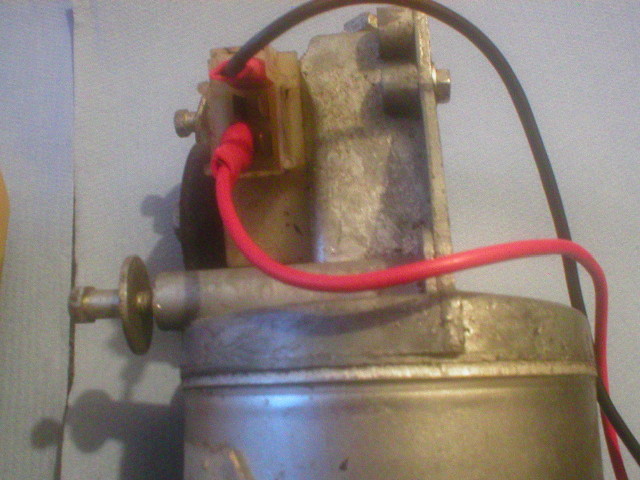

Sorry I'm late on parade with a reply to this. It is an interesting question because of the number of connections running between the windscreen wiper switch and the motor. 5 connections on the motor and 3 on the switch.
I'll try and do a simple explanation of how it works, but it involved a bit of experimentation, as the workshop manual is not very helpful.
Looking first at the connections to the motor we have ....
1. Black wire. This goes to a good earth connection . So far so good.
2. Brown / light green. This is one of the connections to the self-parking contacts.
3. Blue / light green. This is the connection to the high speed brush on the motor.
4. Green . This is the other connection to the self-parking contact. It is always at +12V when the ignition is on.
5. Red / light green. This is the connection to the low-speed brush on the motor.
The connector pins are numbered on the front face of the grey part of the connector.
So first do some basic checks with a multimeter......
1. Check from the black wire to a good earth on the body. It should read less than 1 ohm. Use a thin multimeter probe in the back of the connector.
2. Don't worry about this for now.
3. Check the voltage from the Blue/ light green wire on the connector to a good earth with the IGN ON and the wiper switch in the fast position. There should be +12V here.
4. Check for constant +12V on the plain green wire here when the ignition is on.
5. Check for +12V here on the Red/ light green wire with the wiper switch in the slow position.
If these voltages are O.K. but it doesn't run, or runs slowly, then the motor itself can be checked.
Connect a +12 V supply from Pin 5 ( red/green ) to Pin 1 ( Black). The motor should take a current of about 1.5 A and rotate at about 50 rpm. While it is running, connect an ohm meter between pins 2 ( brown / light green) and 4 ( Green) . This will alternate between 0 ohms and infinity as the self parking contacts open and close. Do check there are no residual voltages on these pins first.
Now connect the +12V supply from Pin 3 ( green / black ) to pin 1. ( Black). The motor will run much faster and mine took about 2.5A.
This checks the basic operation.

- ww connectors.JPG (92.17 KiB) Viewed 2157 times
- ww self park test.JPG (88.87 KiB) Viewed 2157 times
- ww high speed test.JPG (90.47 KiB) Viewed 2157 times
- ww lo speed test.JPG (95.03 KiB) Viewed 2157 times
