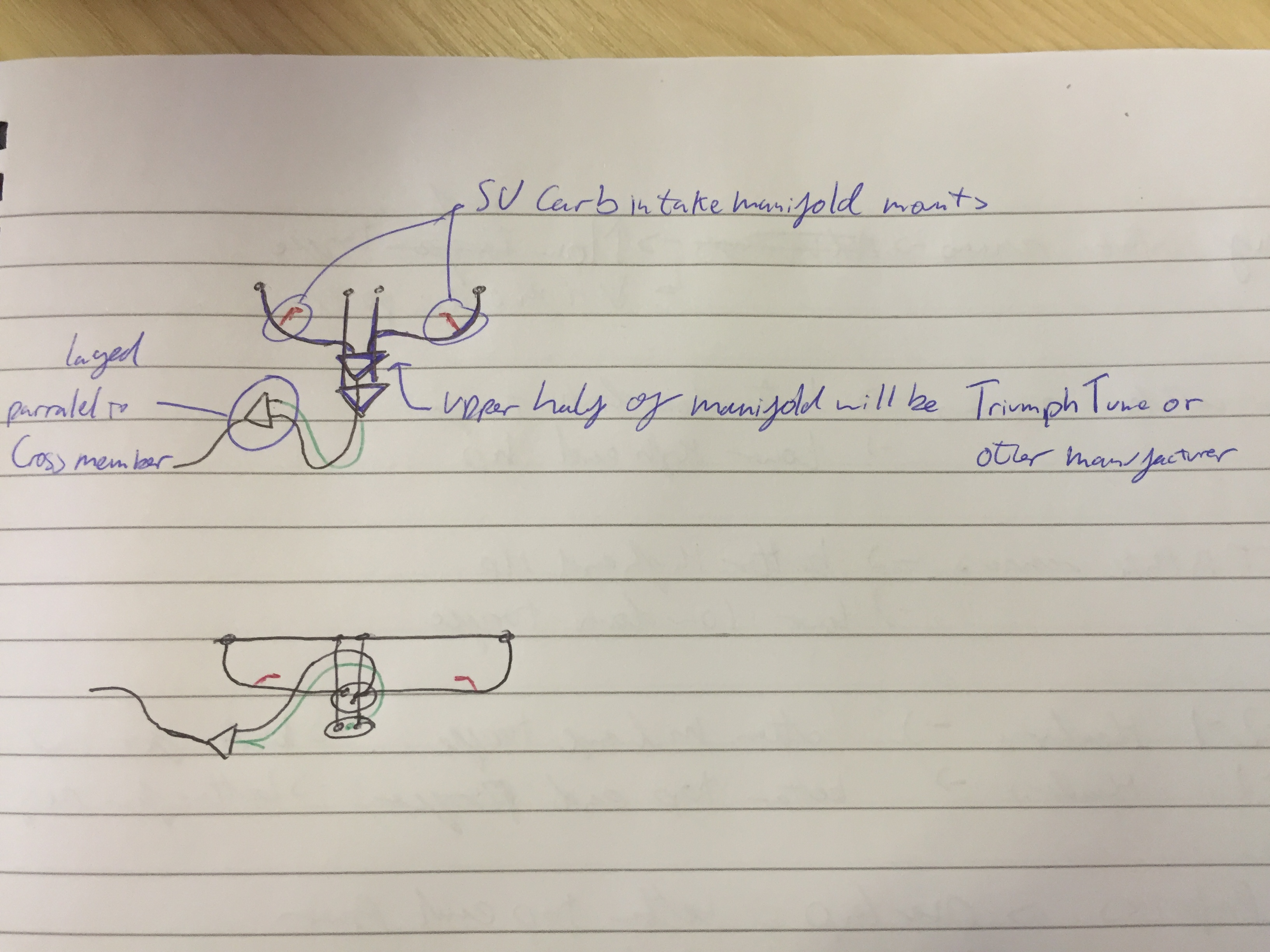

I was thinking something similar to this, if you can understand my line drawing. Taking the tubular manifold and removing any piping after the collectors and then attempt to bend the pipes out to create more space between the block and the collectors. After the manifold, bending a spiral pipe with the start being mounted onto the manifold. The last collector being parallel to the cross member so a s shaped pipe can be attached to bring it under the car, then straight pipe back with a bent section over the axletrackerjack wrote:As a bloke who has made several specials and kit cars there is no reason why not, but I have had 2 Lotus seven type cars and I hate side exhausts so I have made two systems that have rear exhaust for this type of car.
Give yourself at least a day and be handy with a MIG welder!
- image.jpeg (1.38 MiB) Viewed 1435 times

If you can get the primaries to end in the correct spot and at more or less the correct angle, you could use the factory dual downpipe as the secondaries (with the flange cut off of course) then you wouldn't have to fabricate the horribly complicated curves the original makes to get past the subframe nor worry about keeping equal lengths on the secondaries cos it will have been done for you.
Nor will it pay you to make a 4 into 1 collector and a single down pipe, the long secondaries help with torque which is why they are there!

It's something to consider, I'd be using a cropped down 4-2-1 manifold from triumph tune so the primary's are the correct length and all is have to worry about is the secondary length being equal.Carledo wrote:If you can get the primaries to end in the correct spot and at more or less the correct angle, you could use the factory dual downpipe as the secondaries (with the flange cut off of course) then you wouldn't have to fabricate the horribly complicated curves the original makes to get past the subframe nor worry about keeping equal lengths on the secondaries cos it will have been done for you.
From my understanding, 4-1 creates better high end torque, where as a 4-2-1 has better low down torqueCarledo wrote:Nor will it pay you to make a 4 into 1 collector and a single down pipe, the long secondaries help with torque which is why they are there!
- Posts: 7253
Re: Could you fit a sprint exhaust to a 1500TC
Well yes, that is technically correct, but since a 1500 doesn't really have a useable high end, having torque there is a bit pointless. bottom end grunt is far more useful!
