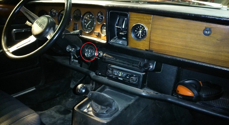

Re: Oil pressure gauge?
I placed the gauge just next to the steering column. I wanted the gauge near the existing ones. The place isn't perfect, spoke of the steering wheel blocks the view sometimes...
Gauge is a perfect match, Smiths and in the same layout as the other: lower half blanked off with the name and type on it, upper half with the standing pointer.
My 1850 runs near 50 psi when cold, lowering to 40 psi after heating up (10w60 synthetic).
And yes, those are ear protectors

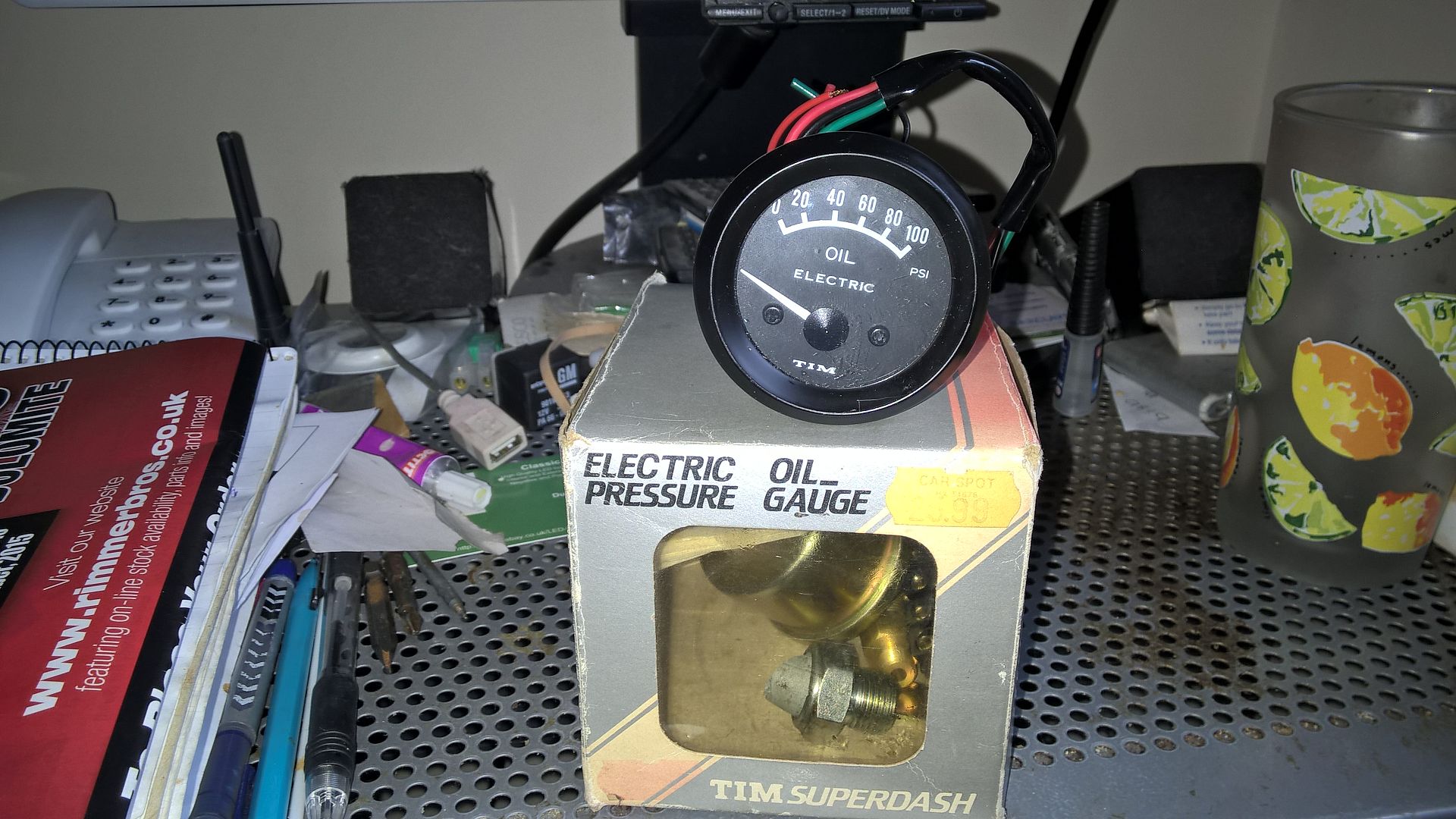

I've had this given so I've decided that I'm going to fit it.
I've bought a mounting bracket and I plan to fit it to the right of the steering column. I just need to mount the bracket, secure the gauge to the bracket(need the nuts and the securing bracket needs some minor "fettling"), fit a T piece (I want to keep my oil warning light) and connect it all up.

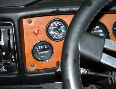

Rob
You could do a little bit of re-wiring and move the temp gauge to where the volt gauge is fitted (do away with the volt gauge) and fit the oil pressure gauge where the temp gauge used to be
viewtopic.php?f=4&t=28506
Paul
Paul

Paul,Flyfisherman wrote:Rob
Paul
Yes I remember that post and I remember being really impressed with the quality of your work. WELL DONE by the way.
I guess that would be the ultimate set up, with an oil pressure gauge on the right hand side and away from the others. That way, if there is any difference in the style of the gauge its not going to stick out like a sore thumb.

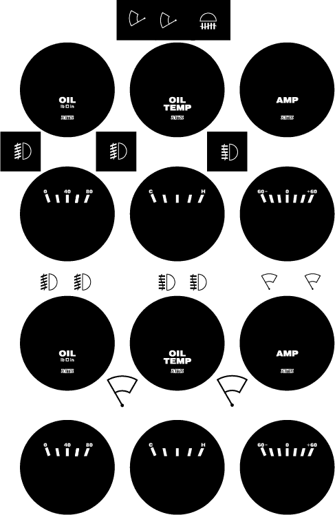

I had these made years ago and had it printed to stick them over the scales of smiths gauges to have the original look.
