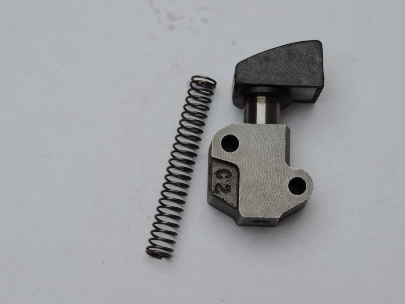

Re: Timing Chain cover removal (sprint)
Since I installed a Rolon tensioner recently, and with all these gloomy posts about its future, when I did an oil change yesterday, I decided to cut the old filter in half to see if I could find any pieces of chewed up rubber. I was slightly relieved when I found none.
Is this the Nissan tensioner? If so its part number is 13070-21002
Cheers,
Rob
Cheers,
Rob
