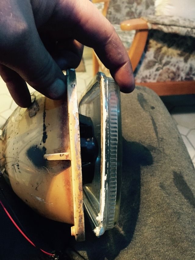

Has anyone ever separated the glass from the plastic backing on the "lesser" model headlights? Need to do it to mine

I've done it numerous times ,most recently on my early Renault based campervan to fit slightly smaller headlamps inside the originals ( new ones no longer available and the reflectors had gone).
The success rate of removal depends entirely on your skill level....good luck!

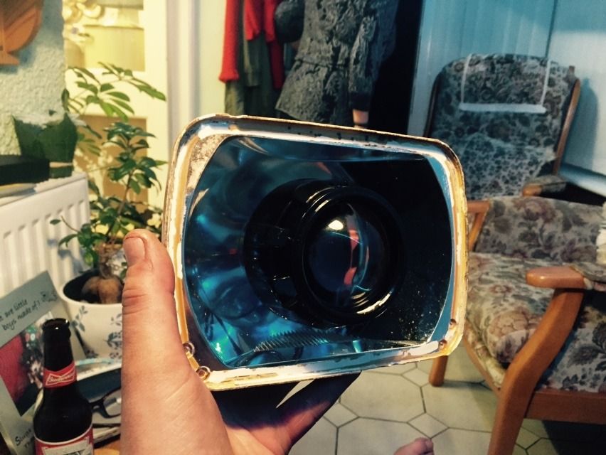

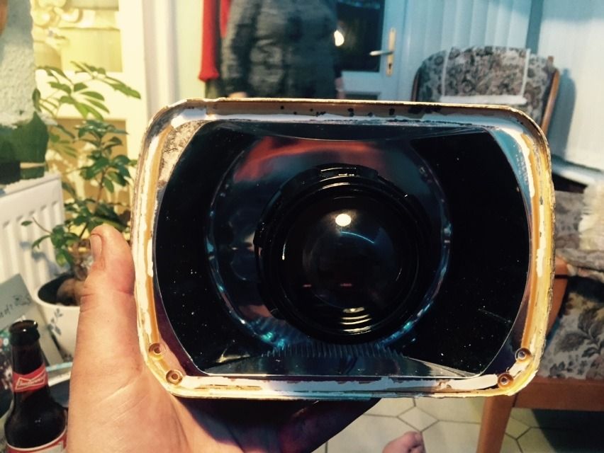

And how is that funny bulb going to work (it won't) with the fresnel lens pattern in your original headlight glass?

Haha. It's a projector unit mate. Should project straight through. Can't fit the poxy things anyway haha

Some fettling will be needed...
Re: Square headlight separation.

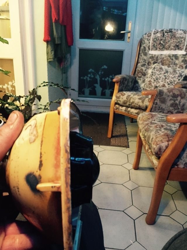

As it'll no longer be necessary for the inside of the unit to be reflective, you could always cut out part of the back and weld in a tube to recess the projector enough for the lens to fit back on.
