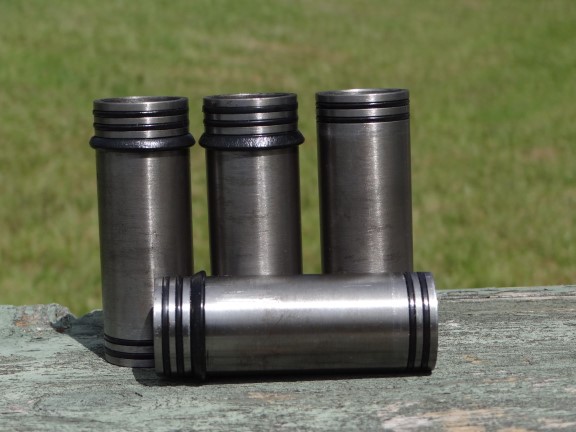

Here's an alternative from the USofA.
http://www.prothanesuspensionparts.com/2749043
Cheers,
Rob
Re: Spark plug tubes. Repairable?
#8 Post by tony g »
Thats a neat solution, almost factory :), but clicking add to basket its not clear if the $37 is for one piece or one set

tony g wrote:Thats a neat solution, almost factory :), but clicking add to basket its not clear if the $37 is for one piece or one set
Tony, if you look in bottom right corner and click on in the box of 2749043 of that product it says 4- Triumph spark plug tube! So looks like it's a set?

#10 Post by xvivalve »
It is astounding that there is sufficient demand stateside for 16v components; there must be a lot of Sprinted TR7 out there I suppose.
OE tubes were aluminium with hard rubber collars bonded to each end.

Graham,
I've just R&R'd mine and I was both wrong and right.
Wrong in assuming that they were the original tubes with the O rings bonded to them, (even though I've had them out before) but right in that they are steel.
I guess someone made these up some time ago for a previous owner.
They're now back in the car with both new O rings and some sealant.

#14 Post by Jon Tilson »
Indeed Rob...those are non OE and someone looks to have made a nice job of them.
