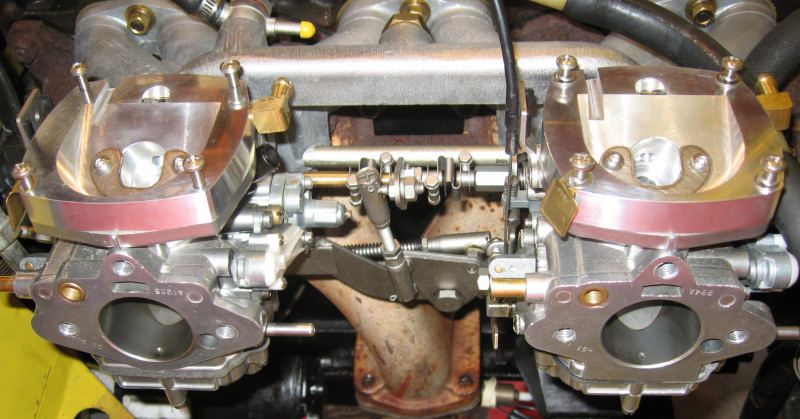

In the classic I saw this and thought of you way, I er, saw this and thought of you! It's a no damage EFI conversion using the standard carb (Stromberg or SU) as a throttle body. American, but I won't hold it against them!

Thanks, I have already looked at they carburrettor conversion adapters.
The biggest limitation with them is that you are still using the original inlet manifold,
ideally you want a separate runner for each cylinder, made as straight and as long as possible.
Whilst an 1850 manifold isn't bad, the TR7 EFI design is much better.

I see that, you do ideally need a manifold with a long runner for a good usable torque response at low to mid revs, unless you're building yourself a race engine that will be sat at high revs most of the time. And of course there would still be just one injector for each pair of cylinders. I guess if you was trying to keep your car as original as possible it's a great idea, otherwise maybe not so.
Take an old manifold down to Bogg Brothers with a fistful of cash and tell them to get cracking!
