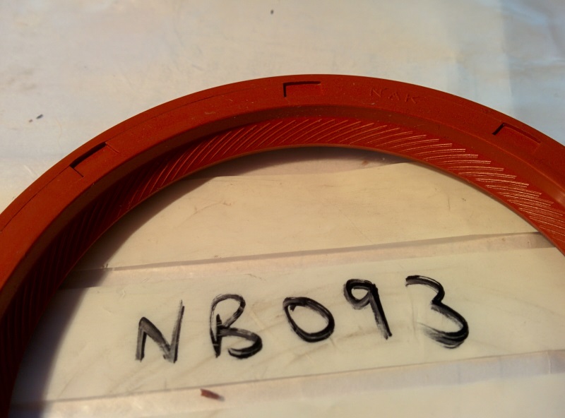

Could not find myself a Payen NB093 out there, so I bought a compatible seal from the Oil Seal UK chap nearby that's branded NAK, hopefully that's one of the good brands!

Is it an automotive seal suitable for the revs and does it have the little oil return grooves? I would not fit just a seal in the right size but make sure it is suitable. There's nothing wrong with the aftermarket ones just the spring.

soe8m wrote:Is it an automotive seal suitable for the revs and does it have the little oil return grooves? I would not fit just a seal in the right size but make sure it is suitable. There's nothing wrong with the aftermarket ones just the spring.
The supplier was very friendly, and specialises in oil seals for classics. It turned up today in the post, as though he's only about 5 miles away I had to have it posted for all of my transport options have issues at the moment except for my boat! It's quite a substantial thing, heavier than I was expecting.
I think these lines on the lip are what you mean Jeroen?

#13 Post by Jon Tilson »
Indeed...
Do compare the spring in that one with the one in your old seal....
