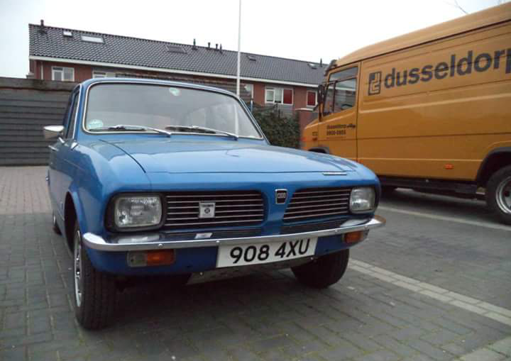

As in lhd country the lucas ones are even more expensive. I do fit Fiat ones in my rectangular dollies. It is a fit but a minor mod must be made. On your UK eBay there are new Fiat sets, two lamps, for around 30 gbp. This is my 1300 with Fiat lamps fitted. They are the 127 128 type.
