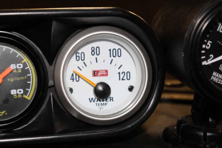

I think I have got slight heating issues guys , I don't think the dolomites were made for our Aussie Hot summers , is just over half way on the temp gauge too hot? or is it ok
Previous owner has removed radiator fan & fitted a thermo fan , I just feel the front end doesn't allowing enough "free flowing "air to run thru the radiator fins, I was thinking of making a grill or holes behind front bumper to allow a bit more air flow?
Would like to hear your thoughts , oh one other question on both my Dolomites the rear back "Dolomite SPRINT "badge has the word sprint in slant , where as I have seen them without the slant font is this an aussie thing? or different years used different badges?
Re: DOLOMITES SPRINTS IN OZ
#6 Post by Jon Tilson »
Welcome to another Aussie friend....
There are a few of you, some not quite so frequently on here as they used to be.
Re the temp gauge....yes a Sprint should be just on half way at normal temperature, but then so much depends on the temp sender and the instrument voltage stabiliser.
What you are looking for is stability and no signs of overheating, like venting from the expansion tank. Keep the cooling system in good condition with suitable corrosion inhibitor
and you should be safe up to the low 30's C. Not sure I'd like to drive one at much over 35 though...cooling is a tad marginal for such extremes, (well they are to us but I know not
so down under).
An electric thermostatically controlled fan is a very good idea.

Even in Auckland on hot days cooling can be an issue. However as long as the car is moving at a reasonable speed it can usually cope. Get stuck in stop-start traffic, work it hard up a long incline and that is when I see problems. You also need to make sure it isn't hot when turning the ignition off or it will likely boil with localised heating and chuck some coolant out. With no frosts where you live, just running with water plus 'water wetter' or a corrosion inhibitor will be much better than anything with antifreeze in it (much better heat transfer). Wiring the radiator fan to continue after you switch off the ignition, either on a timer or better still a thermoswitch is another good idea. The ultimate, and what I now run my racecar with is a Davies Craig 115 electric waterpump with its electronic controller. That way the coolant circulates according to temperature rather than engine speed. However, try the other things first.
I've also stopped trying to second guess the water temperature on a gauge that even when it is working has no point of reference, so I've replaced mine on all three cars. The black faced one is a capillary type and the other, on the race car, is a replacement electrical one. Might not look exactly original, but I DO know what the temperature is. Don't forget too that in a system pressurized at 13psi (0.9 bar?) the boiling point will be closer to 120C, but that will be in the engine, not at the sensor, but I reckon you are safe to an indicated 110-113.

DOLY76 wrote: I think I have got slight heating issues guys , I don't think the dolomites were made for our Aussie Hot summers , is just over half way on the temp gauge too hot? or is it ok
I wasn't going to say anything about this but I'll chime in anyway.
Today I'm replacing the fan in my sprint with a Davies Craig 12" thermatic fan. The ONLY reason for this is that the bearing in the fan support bracket has seized and the one in the alloy hub is also worn. After looking at the availability and prices of both, including postage, and knowing the benefits of an electric fan, I decided to make the switch.
Now, I've only had my SPRINT for 5 years. Its a club registered road car, no motor sport activities (I'm tempted), although I like to drive it "spiritedly" on some of the winding coastal and mountain roads nearby.
In those 5 years the temp gauge has NEVER risen above the normal mark, even on days that are well in excess of 30C. On one summer weekend a couple of years ago, I took it up the Clyde Mountain to a car show in Canberra. It was a stinking hot Summers day, up near 40C, and the temp needle still didn't get above the usual mark. Of course I was taking it steady too.
So, what I'm getting at is, that if the entire cooling system (inc; block, head, radiator, water pump, hoses, thermostat) is in good order, and you aren't giving the thing a thrashing, then you shouldn't have any problems.
Its my belief the Sprints cooling system gets a bad rap mainly because of slack owners who neglect basic maintenance. The water jackets become restricted with gunk, the water pump pushes this gunk into the radiator, then, over the years the car runs hotter and eventually a head gasket blows. After an increasing number of slack owners go through this process the Sprint developes a bad reputation for over heating. The slack/lazy owner is never at fault....just ask him.
The factory fitted, standard radiator is adequate for the job if kept in good condition. Although, a bigger, more efficient one, would be necessary should you decide to get into some kind of motor-sport.
Cheers,
Rob
PS: Don't forget to check for incorrect ignition timing and fuel mixture, as both can cause an engine to run hot too.

As stated above Mario, the best place to start would be to make sure the entire cooling system is clean and clear of "gunk".
Also the gauges can be very "misleading" to say the least. I once was convinced my car was running too hot and tried all sorts of things to get it running cooler to no avail. Then someone suggested I change the gauge & sender unit, did that and guess what? Car ran a consistently full 1/4 "cooler" at all times!.
