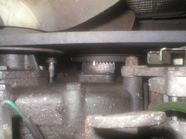

On that train of thought, the first sprint engine mine had, had the jackshaft sprocket bolt loose and it sheared off the dowel pin after a switch off when idling too high. Just in case you do remove the front cover check that too.

Well we are in an area now that is "what if" I will offer another scenario and one I hope is wrong.
It seems to me that the younger Sprint engines from 76 on suffer from a quality issue of the engine crank case material that causes the jackshaft to wear the bore that it runs in, this puts pressure on the water pump skew gear and could break a tooth.
I had a 1980 sprint engine in my first kit car that I built and the jackshaft ate the distributer drive gear.
This was repaired and then finally it ate the water pump gear
My son was with me when this happened in 1996 and I vowed to him that I was never going to sit behind another sprint lump
A year later I bought a sprint that stayed with me till Sept 2013
