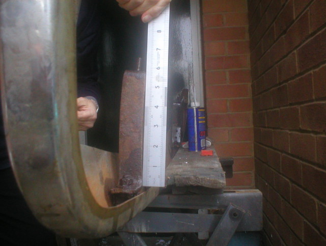

- Posts: 2338
Re: Front bumper bracket/irons
Hi George, This is actually a very interesting post. Until I looked at my old 1850 bumper I hadn't realised they were handed or that they actually bend downwards from body to bumper.
Here is a piccy. The old bumper I have a a bit beyond repair chrome wise but the irons still look good.
If you would like the pair all labelled up L.H. / R.H. drop me a P.M. with an address and I'll send them to you, unless you can collect from the Reading area ?
