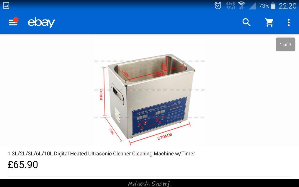

#2 Post by Mahesh »
I found it useful only because I hate wearing gloves for any kind of work (driving with driving gloves excluded).
Mine is the electronic control one, as per spec below,
Power: 100 Watt
Heat Power : 100 Watt
Tank size: 3.2 L
Tank Internal Dimension: 240 (L) x 135 (D) x 100 (H) mm
Weight:2.6KG
Timer: 0-30 min
Ultrasonic Frequency: 42,000 Hz
2 Transducers
Basically 3.2l capacity, but will not fully immerse a complete SUHS6 body, should have gone for larger.
Would probably get better results with proper cleaning fluid, but I just use plain water and a couple of drops
of washing up liquid. (should change to vinegar or lemon juice) don't use white spirit, (headache all day).
Bottom line, is it worth it ?, 70/30 in favour for/from me.

#13 Post by Mahesh »
Mine is not a particular make, but has come down in price a bit.
2016-05-23 22.22.00.png (181.13 KiB) Viewed 655 times
I would still recommend the size up.
